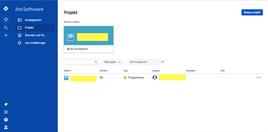

But when I created mine it looks very different:
And as you see this project is in Swedish but I have change my Jira settings to english but it doesnt seem to change the language on each project. Do someone know how to change this?

First, the first screencap is a scrum board in a Jira Server project, the second one is just the place where all the projects are in Jira Cloud. So you need to go inside the project to see the board or the issues.
Jira Sever and Jira Cloud are becoming very different from each other. If you used to work in Jira Server, the projects in Cloud might not look the same.
From your screencap I see you created a Programmers project, that might not be the same as the one you used to work with. If you want to create a project as similiar as possible at what your are used to, I recomend creating a Scrum project or a Kanban one. Then go Inside de project where you will be able to work with the boards.

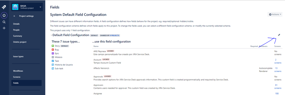

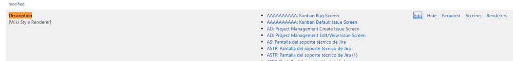

You can put a description in the fields (but not the screens) to help people. The problem is you want to put this in the description, which is a System field, not a customfield. This is a little bit more tricky but you can try.
To put help in the description you will have to do it an Field Scheme in your project.
image.pngEdit it, and find the field Description
image.pngHere you can add a description for the field. (not in the text box)
This is a little bit more advanced and will only work in your project if they are sharing the field configuration so I think you should test it first.
