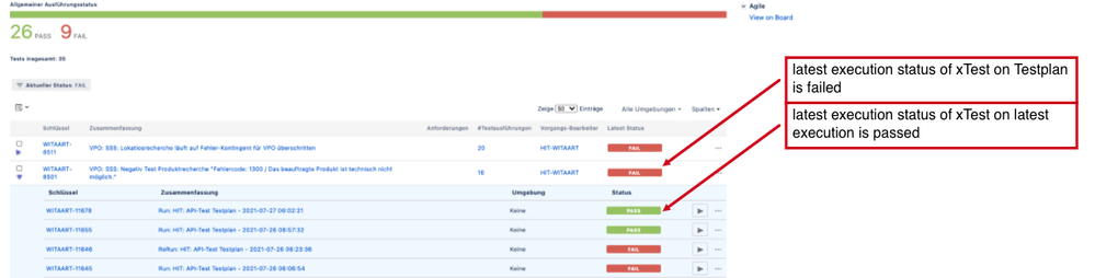

In the testplan you can see that the last status of some tests is "FAIL". When these tests are now opened, it can be seen that the last status of the execution is "PASS". On the testplan level, therefore, the most recent status is not displayed, but an incorrect status. On the screenshot you can see that the test case "WITAART-8501" has the status "FAIL" according to the testplan. As soon as it is expanded, you can see that the last execution status is "PASS".
I have already been able to observe this latency in one or two other test cases, but without any pattern, it seems that a wrong execution status is displayed in the test plan completely randomly.
Any ideas how we can solve this problem?

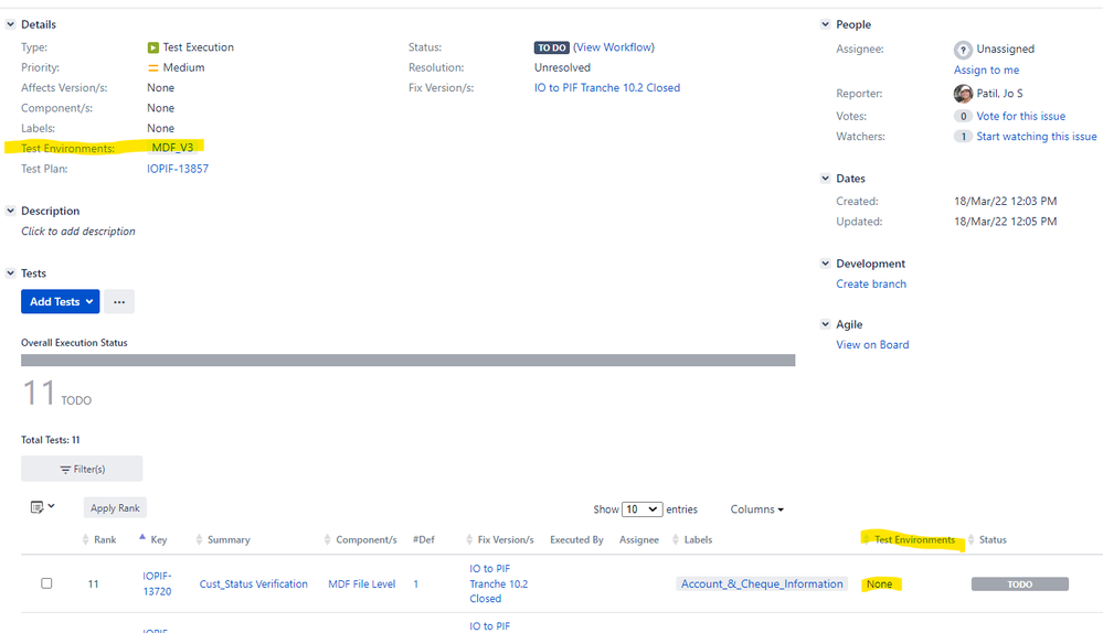

Hi , I was facing the same above problem having incorrect status of test under same test plan for different executions. After looking at this solution , we have stated creating the test environments while creating test executions, but the test environments what we are created are not reflecting as in the blow screen
As the test environment is not reflecting on execution level, it's not reflecting on the test plan level as well. Hence showing incorrect status....Please help us if  we are missing something . Thanks in Advance image.png
