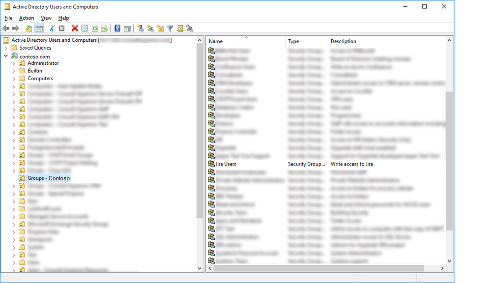

LDAP.pngThe full setup:
*Server Settings
Name: Active Directory
Directory Type: Microsoft Active Directory
Hostname (FQDN of DC): dc.contoso.com
Port: 389, no SSL
Username: CONTOSO\ldapsearch
*LDAP Schema
Base DN: DC=contoso, DC=com
*LDAP Permissions
Read Only, with Local Groups
*User Schema Settings
User Object Class: user
User Object Filter: (&(objectCategory=Person)(sAMAccountName=*)(memberOf=CN=Jira Users,OU=Groups - Contoso,DC=contoso,DC=com))
User Name Attribute: sAMAccountName
User Name RDN Attribute: cn
User First Name Attribute: givenName
User Last Name Attribute: sn
User Display Name Attribute: displayName
User Email Attribute: mail
User Password Attribute: unicodePwd
User Unique ID Attribute: objectGUID
*Group Schema Settings
Group Object Class: group
Group Object Filter: (&(objectCategory=Group)(CN=Jira Users))
Group Name Attribute: cn
Group description Attribute: description
*Membership Schema Settings
Group Members Attribute: member
User Membership Attribute: memberOf
