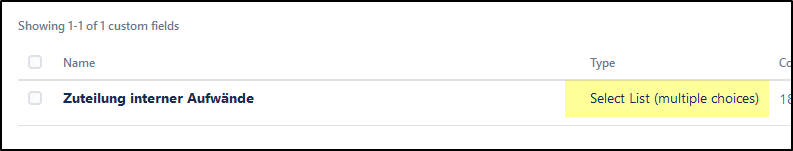

Please share the details on your created rule, with step details and also with the audit log failure details.
What type of custom fields are you using, share details.
All this information will help community members to assist you with your current request.
Josef Sigl
November 18, 2024

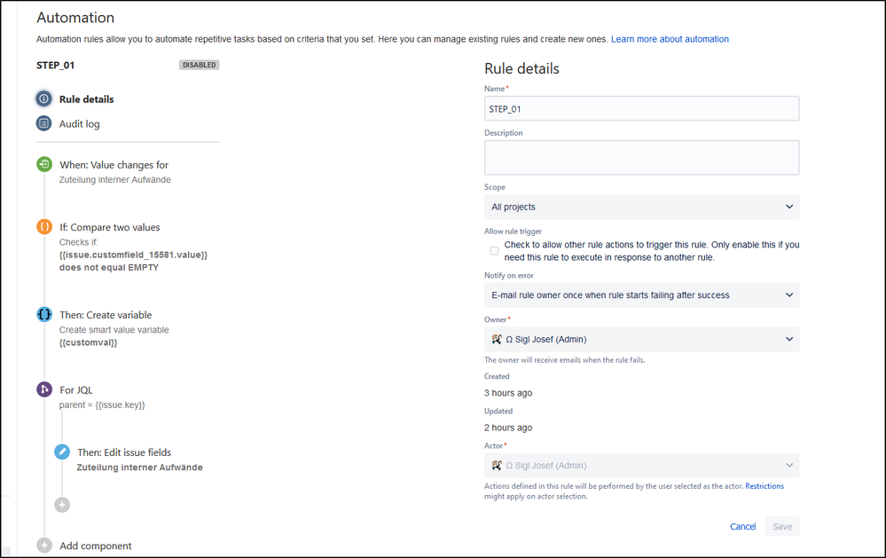

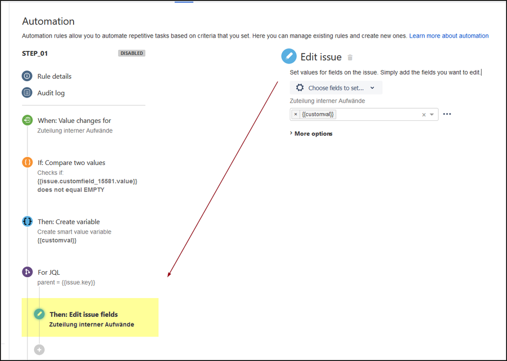

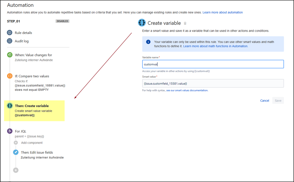

Hi all,

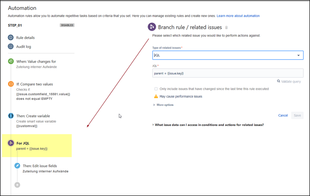

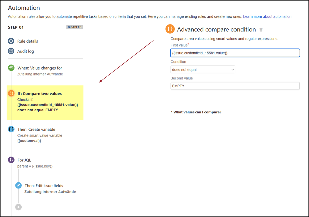

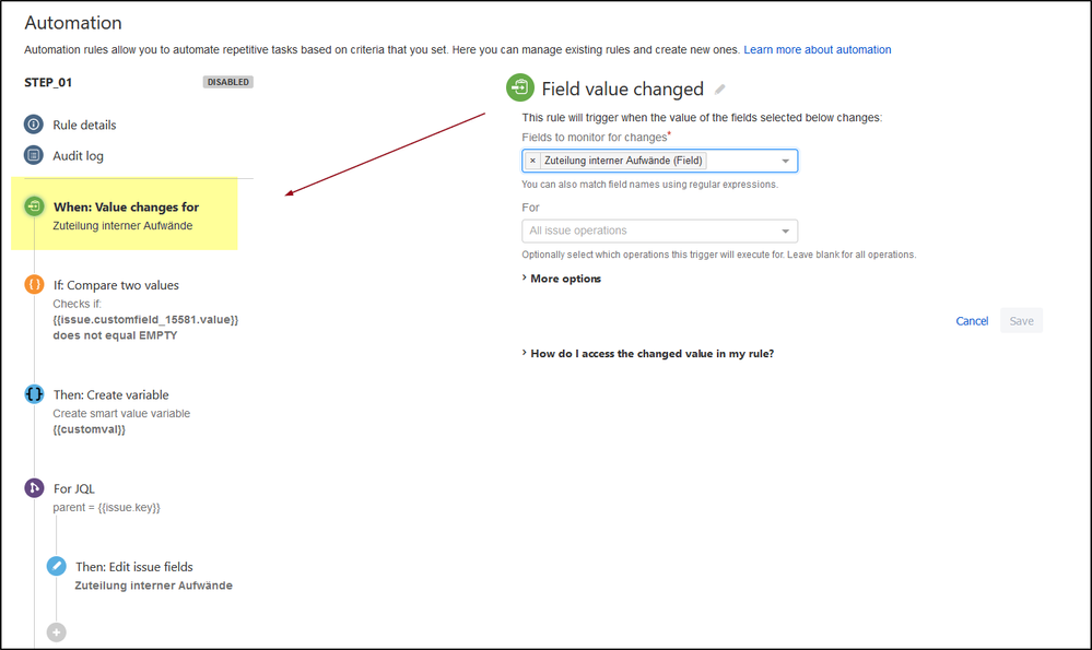

the config of the field
the automation rule

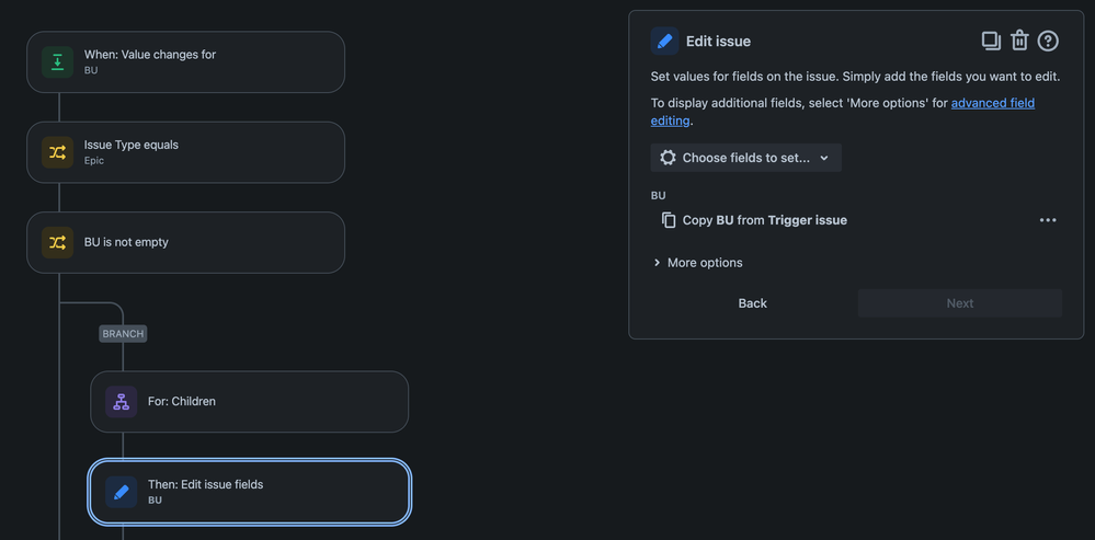

Marc -Devoteam-
November 19, 2024
Hi @Josef Sigl
Do change the values on the Epic or on the Child?
I think my example is simpler, if you make the changes on the Epic side:
Like • Josef Sigl likes this

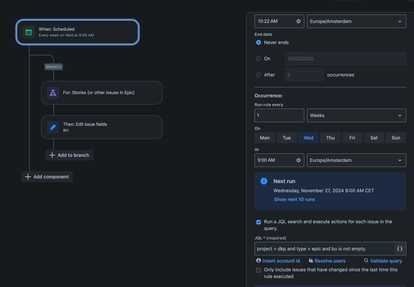

Marc -Devoteam-
November 20, 2024
Hi @Josef Sigl
Copy the Rule I provided and change the trigger, Use a manual trigger.
Then you are able to run that rule on every issue, via the action button, the action it will do is copy the current options from Epic to the children.
Or create a rule as follows, runs this one and then remove it. This rule will find all Epic based on a JQL in the scheduled trigger and then for each found Epic action on the child issues.
