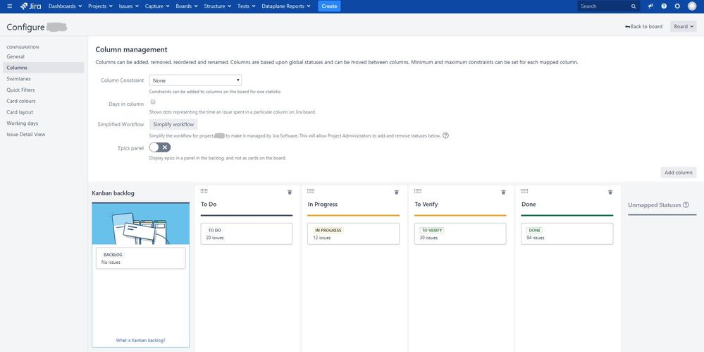

Any way you can do a screenshot of your board settings showing your columns?
László Barta
May 22, 2019
Hi,
Here a screenshot of the configuration page.
John Funk
May 22, 2019
Great - thanks of sending that!
Are there just certain columns you are having trouble dragging between? Or is it every column.
And can you do one more screenshot - this time for the workflow?

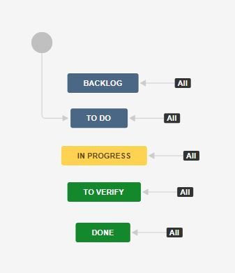

László Barta
May 22, 2019
Sure, Here you are.
It is very simple, and there are no conditions or validators added.
