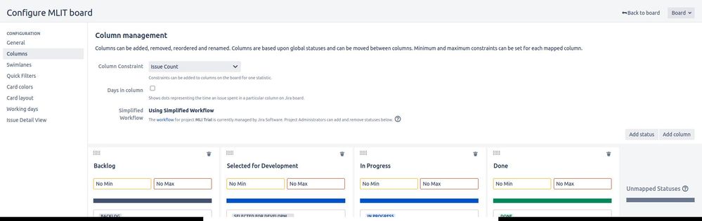

I created an example project based on Kanban, and my expectation was to see a separate colum named "Kanban backlog".
I get this

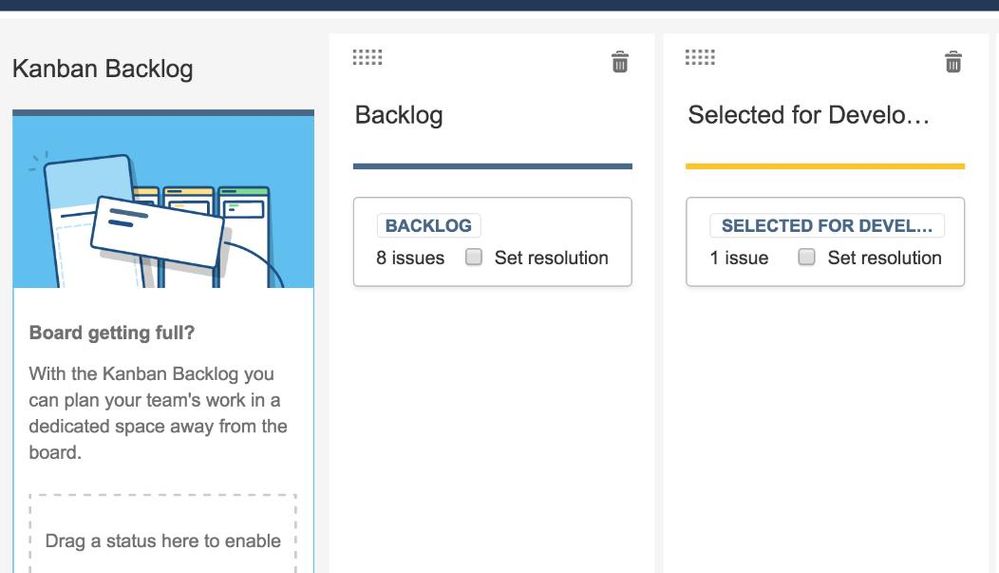

Looking at the documentation https://confluence.atlassian.com/jirasoftwareserver/configuring-columns-938845277.html#Configuringcolumns-enablingkanbanbacklog I see this
And I have not found any project or system configuration that could hide the kanban backlog. If I remember correctly (long time ago) there was enablement of Kanban backlog necessary somewhere in the beta feature ... but that is long ago. Now, the Kanban backlog should be there all the time.
