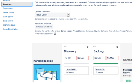

Hi @Zaal Gachechiladze , you could do this:
1) Create a status called 'Discovery' and modify your workflow so this is the status assigned to tickets that were created (or maybe do this for a specific issue type)
2) Create a kanban board where the first column is called 'Discovery' and link it to this status. Have another column called 'Backlog' assigned to status 'Backlog'

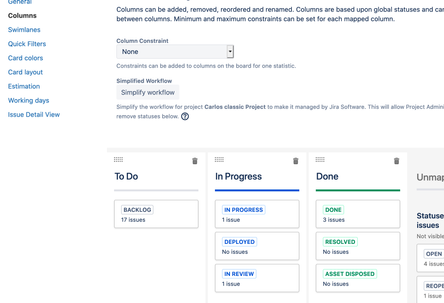

3) Create a scrum board where the status backlog is assigned to the backlog view
 Issues that are created will show up in your kanban board first , but once they've been moved to the 'backlog' column in the kanban board they'll show up in the scrum board.

This is the new Kanban board where I've created two columns, one for Discovery and one for Backlog (you can add more columns if your process is more complex):

This is the Scrum board where the status 'Backlog' is assigned to the 'To Do' column. 'Backlog' was also the status linked to the column 'Backlog' in the kanban board:
