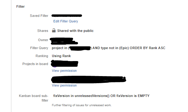

I have a Kanban board using the Simple Workflow. When a previously closed issue is reopened, it's not visible on the board. I realize this is because the board has a Work Sub-Filter: "fixVersion in unreleasedVersions() OR fixVersion is EMPTY".

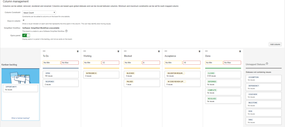

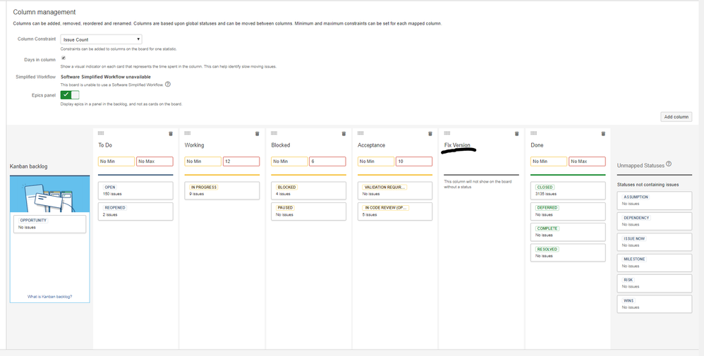

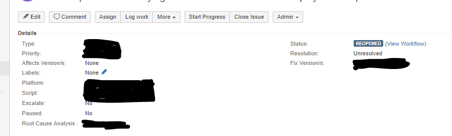

Hi @Jack Brickey Please find screenshots attached. I tried removing the fixversion from the ticket but I don't find any option to edit the field. Capture.PNGCapture2.PNGCapture3.PNG

@Amrita Nair, there are several possible reasons for issues not showing when reopened:
  • it is reopened into one of the "Unmapped" statuses, e.g. assumption, dependency, etc.
  • the board filter excludes issues that have a resolution other than none and you are not clearing out the Resolution code as part of the reopen transition (post function on transition)
  • there sub-filter is excluding released issues and the reopened issue is still showing as released. Note your current sub-filter - fixVersion in unreleaseVersions() or fixVersion is Empty. So if the reopened issue is in "releasedversions() or not Empty then it won't show.

Thank you @Jack Brickey. Unfortunately changing the project filters could possibly affect the board and the volume of tickets in there. Is there a way where we can remove the Fix version from the ticket/mark it as empty while reopening? When i try the edit option/reopen option, I do not see the 'fix version' field there nor is it editable from the view.

1. I can see 2 issues

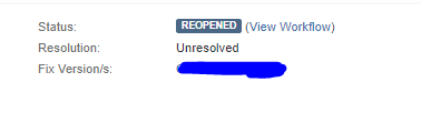

2. Status : Reopened (screenshot)
Capture4.PNG2. In the column list,  Is this how you meant to add a column? If yes, what status should I map here?Please advise.
Capture5.PNG3 & 4. In view mode i can see the fix version, however it is not editable. Tried editing using the edit option as well. The field does not appear in the edit mode.

Amrita, ok so you are getting off track a bit. First remove the column "Fix Version" in your board. You don't want that. What I was trying to convey was simply to display the Fix version field in the columns on the Search issues view not the board view. But you have shown
if you cannot edit the fix version then it may be that you do not have resolve issue permissions. please check on this. project > Settings > Permissions and check Resolve Issues to ensure you fall into one of the groups allowed to do this. BTW, I assume you have system and or project administration permissions? I see you are redacting the Fix Versions in your screen shot and not sure why. I assume these are simply numbers like 1.4, 1.5, etc.
One other thing, in looking at your column config under the To Do column it shows that there are 2 issues in the reopened status. Are you absolutely sure they don't show? The fact that you have 150 issues in To Do is a bit overwhelming and would be a challenge to find anything in a list that big. I recommend creating a quick filter in the board - status = reopened so that all but the reopened are hidden when that QF is selected.
