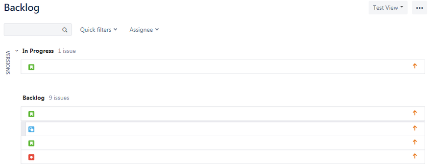

Configuring boards in Kanban: When I move Wishlist and Todo-items to the backlog and delete the Todo-column the backlog behaves weird and shows not only all items in progress but also sometimes gives an empty backlog.
Is that supposed to happen?

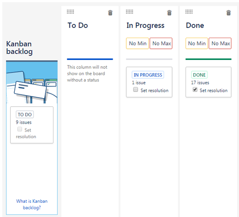

So according to your screenshot I guess you had issues in To do and Wishlist status, and also issues in the In Progress column in your backlog. Adding an empty column next to your backlog should do the trick:
Can you please try to do so and tell us if it helps?

Then the first problem appears, the backlog is containing all items from In Progress

That's weird, it works well on my side:
Or maybe you don't expect the In Progress to be displayed above Backlog? I don't think we can do anything about it since it's the expected behaviour.

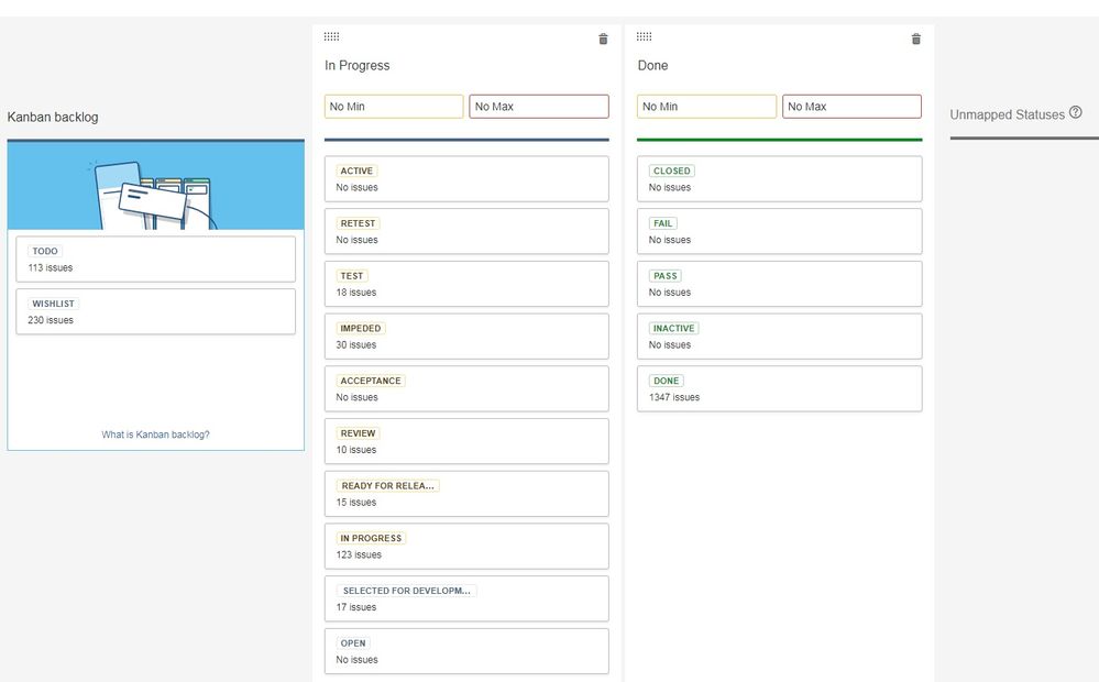

Can you take a screenshot of the Board Configuration--->Column management?
Lena Wikström

I think you need to add the To Do column and make the state Todo, and Wishlist matches To that column.

If I add a column for Selected for Development it behaves the same way, the items marked Selected for development is part of the Backlog even if the config is different.  But doing this means the Todo-items are part of the Backlog list.
If it is not possible to remove the To do-column then maybe it should be stated in the config?

I mean the Backlog shows the In progress items even if it is not part of the configuration
