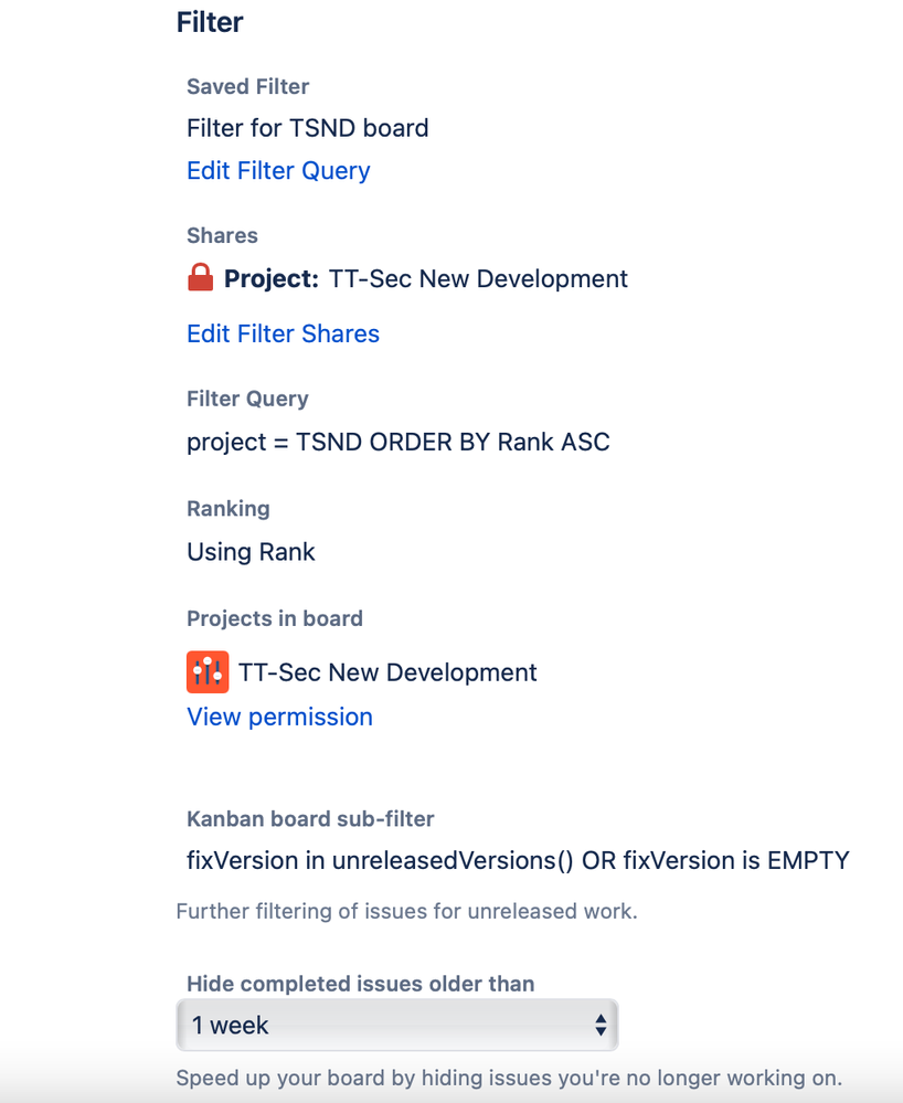

Basically a board is a visual representation of an issue query of the DB with some fancy features for working with those issues. So the reason that the issues are not showing is associated with what the filter. Now the answer here depends greatly on what flavor of project (Classic or Nex-gen template, software or business, etc) you have. Could you share an image of your empty board?

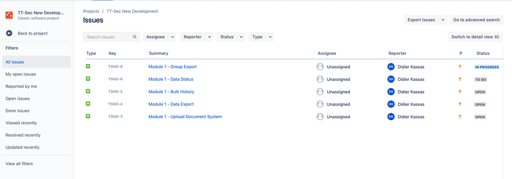

Attached are screenshots of my boards and issues.
as far as I am aware I am working on the Classic software templates.
Thank you for your help
Screen Shot 2021-02-16 at 3.51.31 PM.pngScreen Shot 2021-02-16 at 3.51.19 PM.png

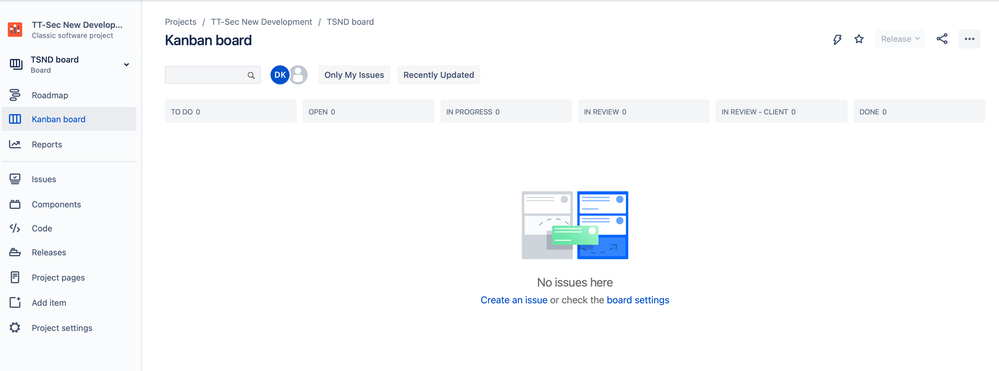

Didier Kassas
February 16, 2021
please find attached
Jack Brickey
February 16, 2021

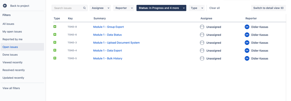

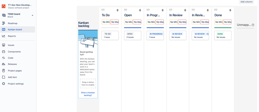

thanks for the images.
Yes you are on Classic. According to your filter you should see all open issues (resolution not set) and any where the resolution has been set less than 1wk prior. Now are you sure you have open issues? Check by clicking on the Open issues link in sidebar image 1. If you do please check board settings > columns and ensure you have statuses mapped to the columns, i.e. they aren't all sitting to the right in unmapped statuses.
Didier Kassas
February 16, 2021
hey Jack,
please see screen shots of the 2 areas you talk about above, Bothe are as they should be.
Screen Shot 2021-02-16 at 6.48.55 PM.pngScreen Shot 2021-02-16 at 6.49.30 PM.png
Jack Brickey
February 16, 2021
well that is interesting. it looks good and your columns even show that there should be 1 in To Do, 3 in Open and 1 In Progress which equates to the 5 total issue in the previous image. It doesn't appear there is any quick filter applied here but do check that. can you try assigning one or more to you and then click on "assigned to me" just for grins. i don't expect to see anything. Something has to be filtering these issues out. I don't think it is Issue Security since you see them in Open issues list. So I see that you have a dropdown for your TSND board. Do you have another board defined? Can you click on the dropdown and select if so?

ok so we are overlooking something totally basic here or there is a very weird bug. I'm placing my bet on the former. Do me a favor an remove your sub-filter and change your hide completed issues to never hide.

Can you please share the board filter of the project?
