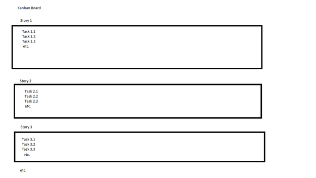

And that is how I want my Kanban Board look like:

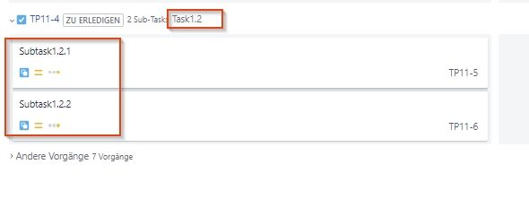

Hi @Craig Nodwell this is the result i get when i set the swimlanes based on Stories using the option:

Yes, that's working as designed.  The story itself is the swim-lane, it's children cards display below.
Bayar Said
December 30, 2022
No, the swimlane itself is based on Task 1.2 and showing me only the sub-tasks of Task 1.2.
Task 1.1, Story and its tasks of my second epic are missing totally..
What I want are swimlanes for each Stories, like this:

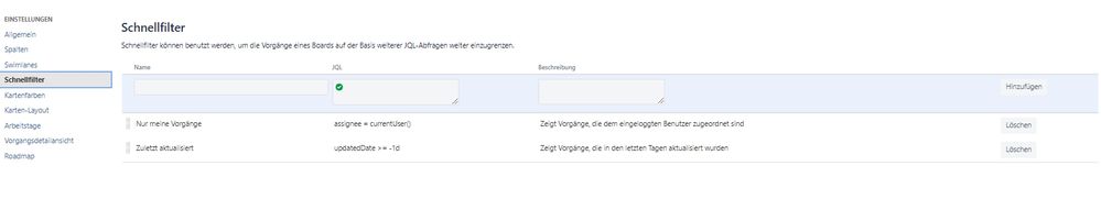

I haven't set any filters yet.. only the basic filters are inserted.
Craig Nodwell
December 30, 2022
Those are quick filters.  The board filter is on the general tab.  :)

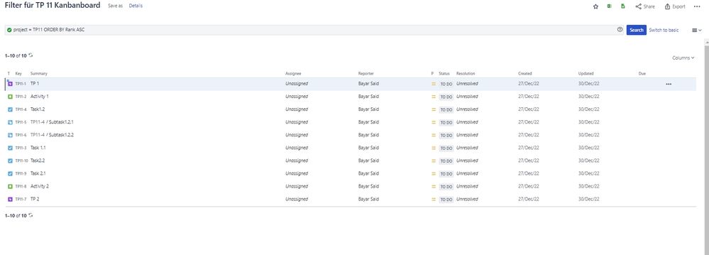

Is this board the correct one?
Craig Nodwell
December 30, 2022

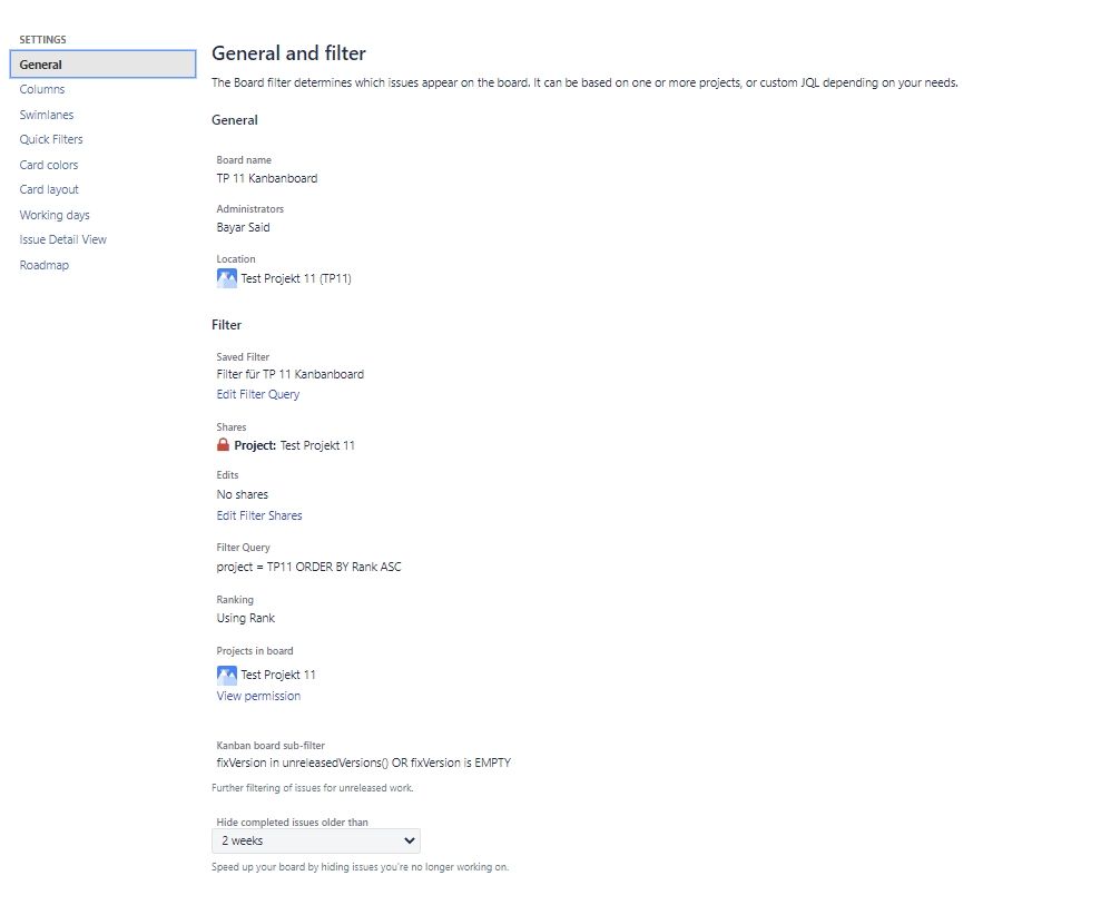

If you go back to the board configuration, then into the General Tab it will give you both the name of the filter and the contents of that filter will also be displayed.  Since you are setting up Kanban you'll also have the ability to apply a sub-filter to the board.  Go look there :) it's probably very basic like project = xxxx
Bayar Said
December 30, 2022
I got it. I guess this is the board you were looking for.
