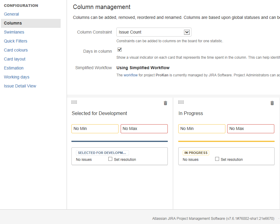

I'm using JIRA Software Server 7.6 and I don't get the option to enable the Kanban backlog.  The configuration page for the board's columns does not contain a panel to enable the backlog

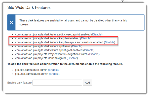

Probably a Dark Feature is missing.
Go to the Dark Features System Administration Page:
https://<yourserver>/secure/SiteDarkFeatures!default.jspa
Check your enabled Dark Features. These two Features need to be enabled.
  • com.atlassian.jira.agile.darkfeature.kanplan.enabled
    (enables the kanban board backlog)
  • com.atlassian.jira.agile.darkfeature.kanplan.epics.and.versions.enabled
    (enables the epic and version tab for the kanban board backlog)
When I had updated from Jira 7.2.1 to Jira 7.7.1, the first of these two Dark Features (kanplan.enabled) was missing and the Kanban Backlog was not configurable.

Having the same problem as described above. Updated Test platform from 7.2 via 7.4 to 7.8, Kanban backlog works as expected. Prod platform directly from 7.2 to 7.8, Kanban backlog is not visible. Also not able to add a Sprint Goal to a sprint. Checked the Dark Features, they are identical to the screenshot above. What am I missing? Maybe a reboot of the Jira server?

I've been to the board settings and checked (as per the documentation) the columns tab but I don't see the area described as the Kanban backlog.  I don't have the option to drag any status onto a Kanban backlog area to enable it.

(Sigh) I can see that on the screenshot. I have my personal Cloud account and that's how I found it.

After upgrading our Test System from Jira 7.2.1 to Jira 7.7.1, I have the same problem.
The Kanban Backlog Panel is not visible (same as your screenshot shows).
