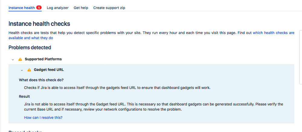

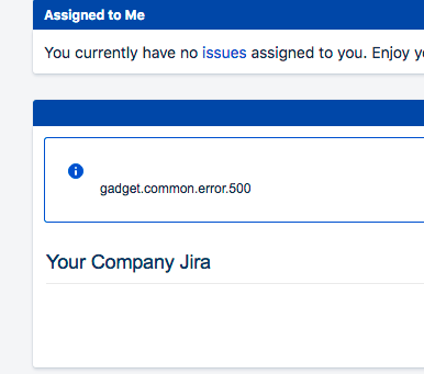

I've got the same issue but I am using Jira behind Apache24 proxy.
I've tested everything mentioned in this post and manuals but still getting troubles.
My configuration is:
Screen Shot 2019-04-30 at 16.15.40.pngScreen Shot 2019-04-30 at 16.18.19.pngScreen Shot 2019-04-30 at 16.21.29.png
Is there something special that I've got missed?

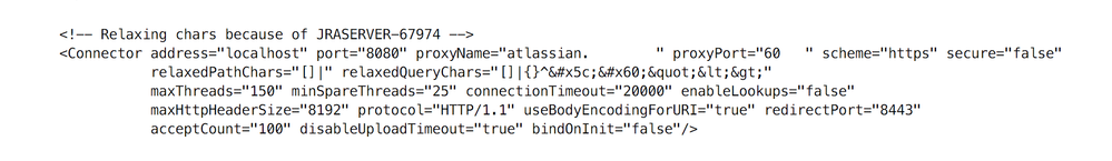

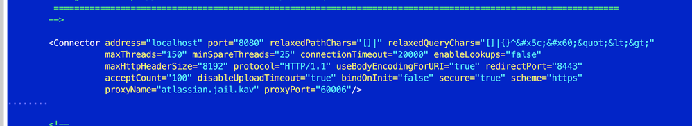

For now I am using default that I've uncommented from pure server.xml just after reinstall. The previous image not valid already. This is my current file:
Should I use from your message or from default server.xml?

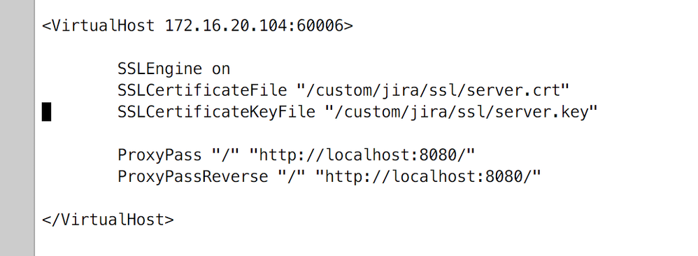

It's from apache config
<VirtualHost 172.16.20.104:80>
ServerName atlassian.jail.kav
Redirect Permanent / https://atlassian.jail.kav:60006
</VirtualHost>
<VirtualHost 172.16.20.104:60006>
SSLEngine on
SSLCertificateFile "/custom/jira/ssl/server.crt"
SSLCertificateKeyFile "/custom/jira/ssl/server.key"
<Proxy *>
Require all granted
</Proxy>
<LocationMatch "^(/rest)/[^/]+">
AuthType None
Require all granted
</LocationMatch>
<LocationMatch "/">
Order allow,deny
Allow from all
</LocationMatch>
ProxyPass / http://localhost:8080/
ProxyPassReverse / http://localhost:8080/
</VirtualHost>
Daniel Eads
April 30, 2019
Based on this connector, Jira's base URL should be configured as:
Can you double-check Jira's base URL setting now in the Administration section to see if it matches there?

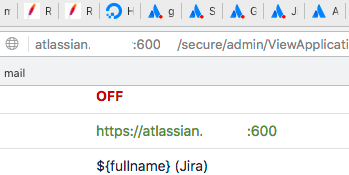

This is the first that I've started to check 15 hours ago. At time of my first attempt to install Jira 8.1 This version of server been installing behind Apache SSL from begin but not setup SSL after installation.

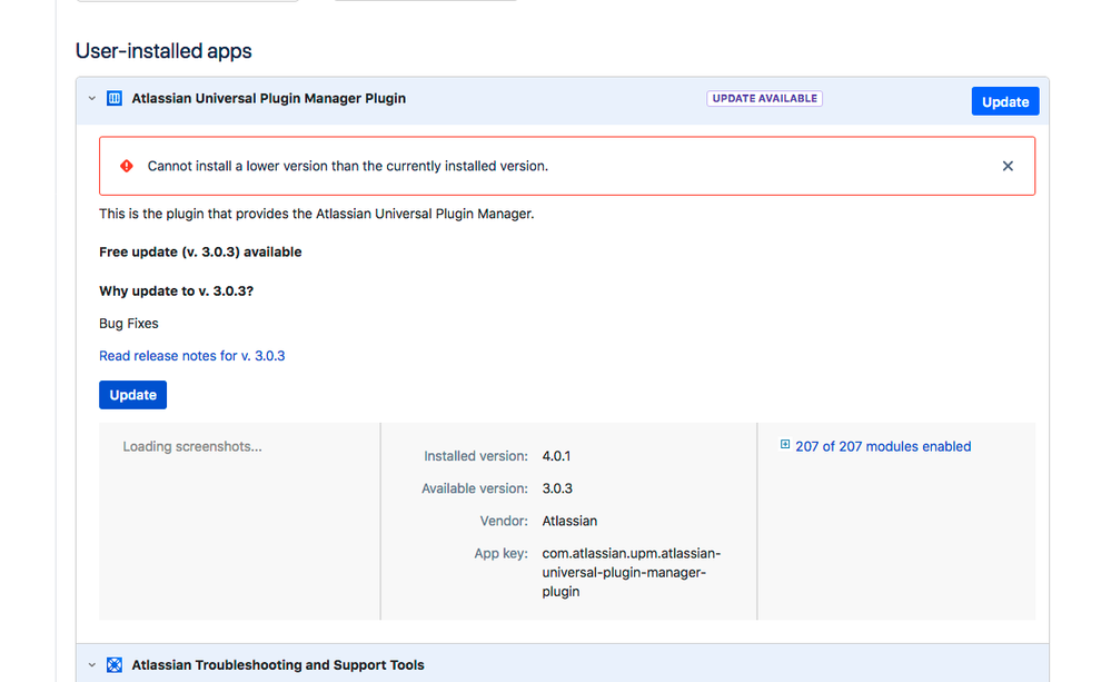

Be honest this version is surprising me VERY MUCH. It's the 4th trouble that I am getting. Next one is this:
I don't know where it should be published. You might to move it anywhere ...
Daniel Eads
April 30, 2019
Hi Alexandr,
It looks like there may be extra parameters in your server.xml connector that are unnecessary. In addition, I think some parameters like secure in your example are not set to what you want them to be. Here's a cleaned up connector for you based on your screenshot:
<Connector
port="8080"
relaxedPathChars="[]|"
relaxedQueryChars="[]|{}^\`&quot;&lt;&gt;"
maxThreads="150"
minSpareThreads="25"
connectionTimeout="20000"
enableLookups="false"
maxHttpHeaderSize="8192"
protocol="HTTP/1.1"
useBodyEncodingForURI="true"
redirectPort="8443"
acceptCount="100"
disableUploadTimeout="true"
bindOnInit="false"
secure="true"
scheme="https"
proxyName="atlassian.UPDATE"
proxyPort="60006"
Make sure you update the proxyName parameter to whatever your domain name is for Jira. As a reminder, changes to server.xml require restarting Jira before they take effect.
Cheers,
Daniel
