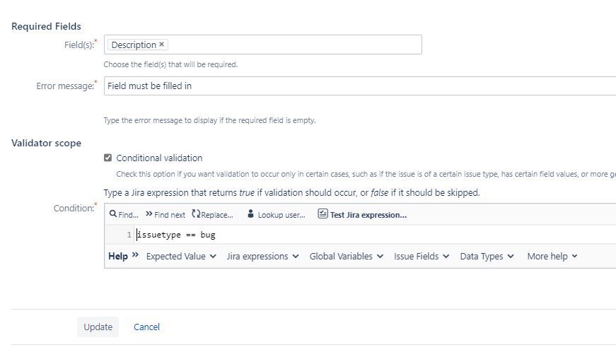

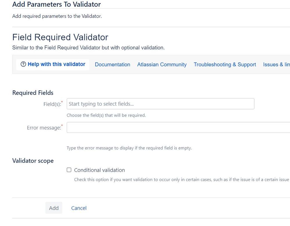

im looking to add a validator to a specific issue type that insists on certain fields to be filled in before the ticket can be created.
I’ve added a validator that’s asks for example, the description, to be filled in on new bugs created (description is just one of the fields I’ve tried to get this to work on)
in the validator option I’ve added the “issuetype == bug” formula and the custom response. This all seems to work well however,
when I try it, I create a bug and leave the description blank. This gives the custom response I added and it won’t let you create the issue however, even if I fill in the description, it still won’t let me create?

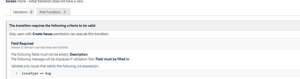

Hi @paul stafford ,
your Conditional Validations script syntax is incorrect. Try this instead:
issue.issueType.name == "Bug"
Oliver Siebenmarck _Polymetis Apps_
February 7, 2023
Hi @paul stafford ,
Your Jira Expression isn't quite correct. Here's what should work:
The issue object has an attribute called issueType which in turn has a name that may or may not be "Bug". The above Validator would only be true for issues of type Bug.

Hi Oliver
Ive updated that however it still doesnt recognise when I type something into the description field.
Its not limited to this field either. If I choose "sprint" cant be left blank, it doesnt recognise when I add one - same for any field really?

Trudy P Claspill
February 6, 2023

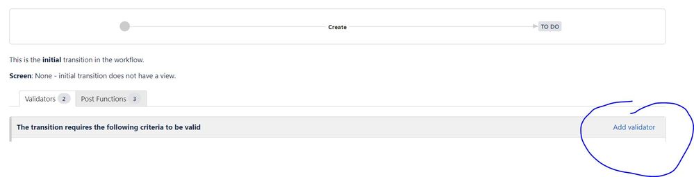

Please show us the complete set of Validators for your Create transition.
paul stafford
February 7, 2023
Trudy P Claspill
February 7, 2023
This doesn't appear to be the native Field Required validator for Jira Cloud
Do you have a third party app installed that provides additional workflow functionality? If so, which one?

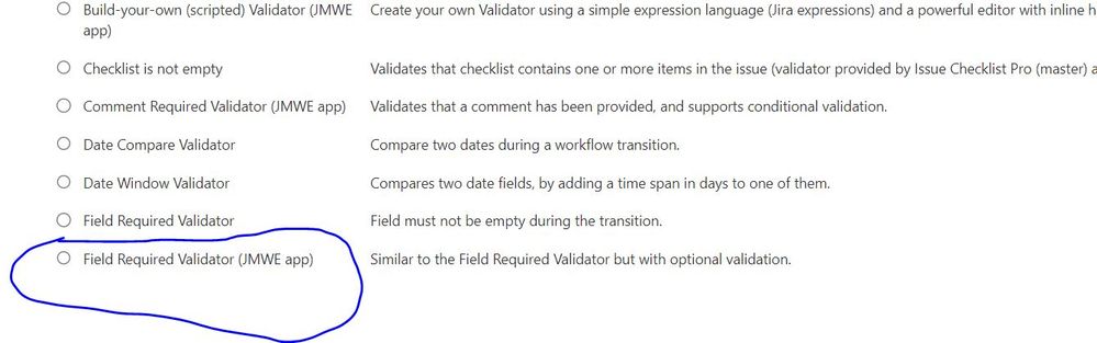

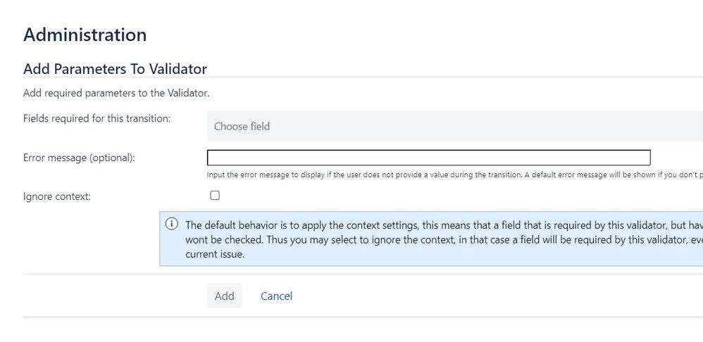

paul stafford
February 7, 2023
Hi Trudy.
Ive included images of the steps taken to add this validation.
I chose this option (JMWE.app) as the one that appears to be native didnt bring up options for additional fields that are on the issue screen, its just had a list of a basic few.
It also doesnt allow the optional condition that allows me to specify it on bugs only.
Image 4 is the one that appears to be the native onevalidator1.JPGvalidator2.JPGvalidator3.JPGvalidator4.JPG

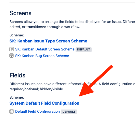

In a Field Configuration Scheme you associate a Field Configuration with an Issue Type. Within the Field Configuration you can specify that a field is Required or Optional. If you specify it as Required then it will be required all the time. You will want to make sure the field appears in your Create Issue, Edit Issue and View Issue screens.
If you go to Project Settings for the project, and click on Summary, that will show you the Field Configuration Scheme and the Field Configurations it contains.

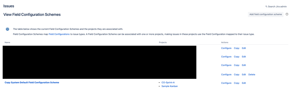

Go to the Administration screen for Field Configuration Schemes
https://<yourCompany>.atlassian.net/secure/admin/ViewFieldLayoutSchemes.jspa
Find the name of the field configuration scheme. This screen will show you all the projects that use that field configuration scheme.

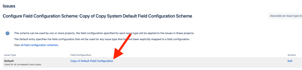

If it is used by more than one project, click on the Copy option on the right to make a copy of the scheme. The copy will include in it the original Field Configuration.
On this screen click on the name of the Field Configuration Scheme you created. Within the new screen, make a note of the name of the Field Configuration.

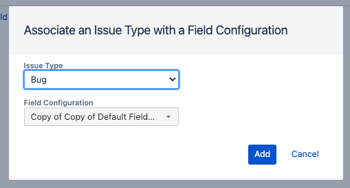

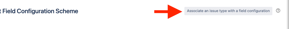

After you finish that, go back to the copy you made of the Field Configuration Scheme. Click on the Associate button.
Select the Field Configuration you were just updating to make more fields required, and the issue type you want to apply that to, and click Add.

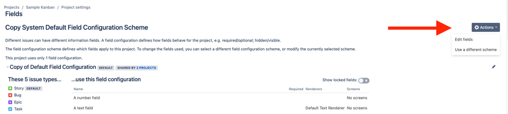

And finally, go back to the project, to Project Settings / Summary, and click on the Field Configuration Scheme name, as shown in the first image in this reply.
You will find an Actions button there. Click it and choose Use a different scheme
You'll be shown a screen with a pick list where you can select that new Field Configuration Scheme you created.
