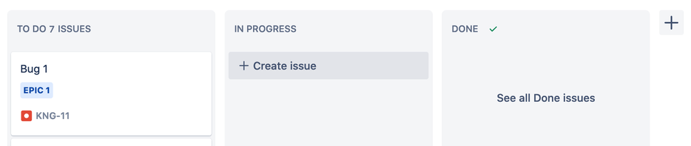

Testing on my local site on a next-gen Kanban project, when creating an issue using the Create button or using the shortcut “C”, the ticket is created and listed as the last one on the backlog. It’s not automatically added to the board.
In this case, it’s necessary to manually move to the board or sprint.
If you go to the backlog and create the issue from Screen Shot 2021-04-21 at 16.42.31.png, does it work?
If you are not using Sprints, it’s possible to create an issue directly in the Board, but only if using the “+ Create issue” option, otherwise, it will be on the Backlog (last issue on the list).
On a Cloud free site, anyone with a license will be able to manage a project, so it’s not a permission issue.
Also, the issue types that are not visible on a board are Epics and Sub-Tasks. Tasks should appear normally.
