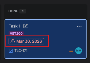

Do you mean by overdue flag the due date is being marked red, for example in the Kanban board, like this (image below)?
In my case, when I transitioned the issue to a status in the done category, the due date became a normal due date without the red color and the warning sign.

Yes, that's correct. when a due date is before todays date it marked as red as showen below even if the issue is moved to done status.

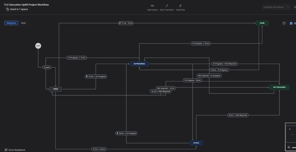

Could you show a screenshot of your workflow?
Md Mostofa Maruf
April 1, 2026
That's the workflow:

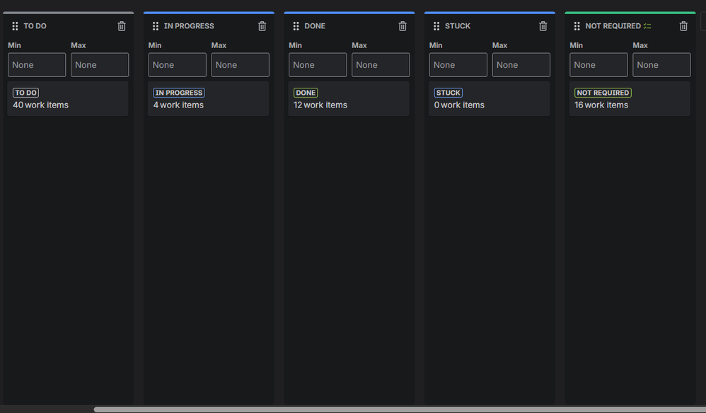

board columns with status

Ok, so I can see different things here. What I would try is the following:

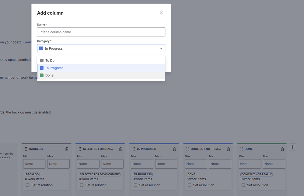

Instead of having the DONE column an "In Progress"-column, create new one called DONE, but as a "Done"-column:

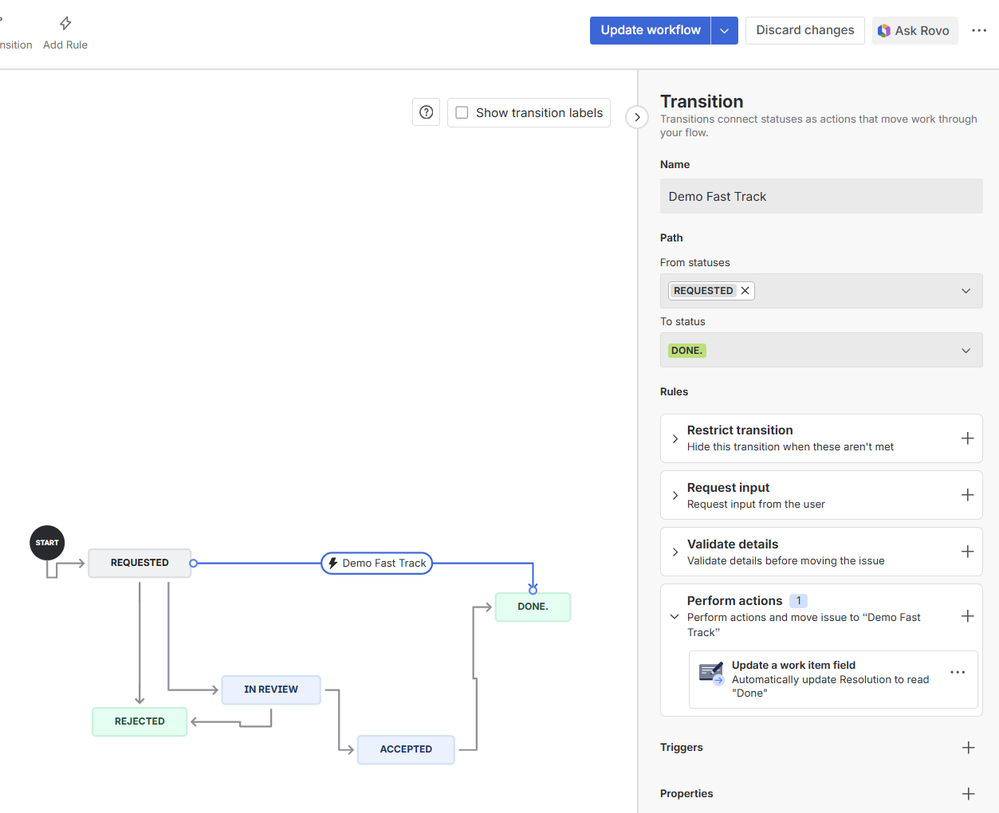

In the workflow, make sure you have enabled that the transition sets a resolution when you move an issue to done (Perform actions > Update a work item field > Set resolution to Done):

Hi Sandro,
Thank you, the solution worked well. I appreciate your assistance.
For the existing issues, I set up a scheduled automation rule to update the resolution to “Done” or “Won’t Do”, as these tasks were created before the workflow actions nabled that the transition sets a resolution.
