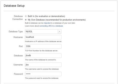

I start Jira and get to the Setup instructions:
(Google example picture)
"Test connection" works fin.
I click next and get an 502 Error from Nginx and reload and anithing won´t work.

I have tried it now with the built-in database. The setup has gone through with a few timeouts. Is it perhaps the two networks and the communication to the database?

Hi @[deleted] ,
It looks like the database is working perfectly fine, the problem is NGINX cannot access the localhost:8080.
You have to make sure that nginx can actually access the local instance of jira.
There is a command for it in linux.
