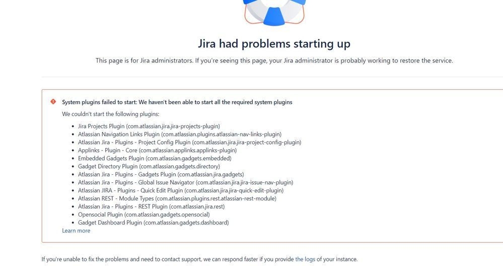

I am practising API's on ocalhost:8080 but today jira start up failed.
Clicked on start-jira where the tomcat window closed quickly and hence executed  'Start-jira.bat /fg ' from command prompt after which I see the below error in my browser on hitting localhost:8080 . Please advise.
System plugins failed to start: We haven't been able to start all the required system plugins
We couldn't start the following plugins:
  • Jira Projects Plugin (com.atlassian.jira.jira-projects-plugin)
  • Atlassian Navigation Links Plugin (com.atlassian.plugins.atlassian-nav-links-plugin)
  • Atlassian Jira - Plugins - Project Config Plugin (com.atlassian.jira.jira-project-config-plugin)
  • Applinks - Plugin - Core (com.atlassian.applinks.applinks-plugin)
  • Embedded Gadgets Plugin (com.atlassian.gadgets.embedded)
  • Gadget Directory Plugin (com.atlassian.gadgets.directory)
  • Atlassian Jira - Plugins - Gadgets Plugin (com.atlassian.jira.gadgets)
  • Atlassian Jira - Plugins - Global Issue Navigator (com.atlassian.jira.jira-issue-nav-plugin)
  • Atlassian JIRA - Plugins - Quick Edit Plugin (com.atlassian.jira.jira-quick-edit-plugin)
  • Atlassian REST - Module Types (com.atlassian.plugins.rest.atlassian-rest-module)
  • Atlassian Jira - Plugins - REST Plugin (com.atlassian.jira.rest)
  • Opensocial Plugin (com.atlassian.gadgets.opensocial)
  • Gadget Dashboard Plugin (com.atlassian.gadgets.dashboard)

Hi,
Thank you.
I followed the Resolution 1 in the below URL:
https://community.atlassian.com/t5/Jira-questions/jira-startup-failed/qaq-p/1215226
Backed-up .bundled-plugins and .osgi-plugins , then deleted them, cleared temp and restarted service and it was successful.
However, after this, I am unable to create a new scrum project which was working fine until yesterday.
This is the input:
Body:
"key": "QA2",
"name": "QATEST2",
"projectTypeKey": "software",
"projectTemplateKey": "com.pyxis.greenhopper.jira:gh-scrum-template",
"description": "Example Project description",
"lead": "csugirtha"
I am facing the below error:
"errorMessages": [
"The project template specified does not exist. Make sure the project template is available in your Jira instance. Please talk to your Jira administrator if you need more help."
"errors": {
"projectType": "An invalid project type was specified. Make sure the project type is available in your Jira instance. Please talk to your Jira administrator if you need more help."
When I checked, all those plugins are back after restarting JIRA. I'm clueless now. Please assist.
Fabio Racobaldo _Catworkx_
February 23, 2022
Hi @sugirtha chandrasekaran ,
please check that JIRA Software started succesfully. Go toAdmin section -> Application and check it.
February 23, 2022
@Fabio Racobaldo _Catworkx_ Hi,
Thanks. I installed it from admin>application, restarted the jira through bin>start-jira and able to create  scrum project.
Thanks much :)
