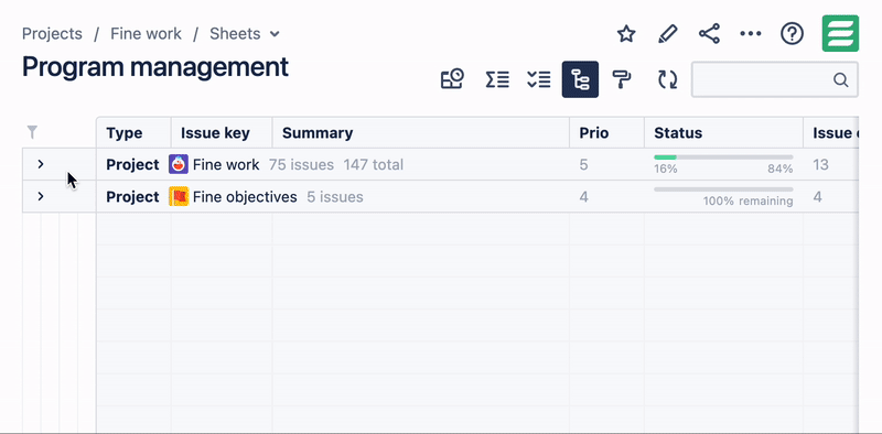

@Padma_Agarwal following up on my earlier answer - once you get the hierarchy sorted in Plans, you may still find that the "group by label" approach is fragile: labels are free-text and any typo or inconsistency breaks the grouping.
If you end up wanting a more flexible cross-project portfolio view, it's worth knowing that if you're open to solutions from the Atlassian Marketplace, JXL for Jira lets you build multi-project hierarchy views that can group by any field - including labels, components, fix versions, or custom fields - without relying on Plans hierarchy configuration. Each epic and its child stories from different boards show up in the same view, and the grouping is live.
Disclosure: I work for the team that builds JXL.
