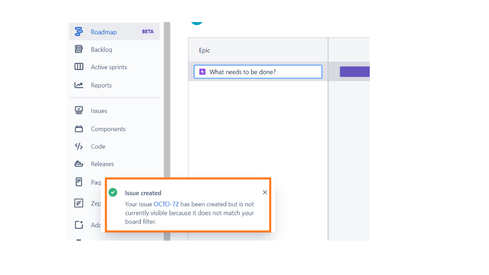

Hi Team,
I am not able to create an epic under roadmap. It says " your issue is created but not visible because it does not match your board filter".
Please support at the earliest.
Thank you

Hi JA - Welcome to the Atlassian Community!
You need to check the filter associated with the plan/board you are using. It might be that it was created against a different project or is using different components or something like that.

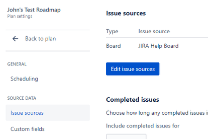

John Funk
October 14, 2020
Click on the gear icon for Settings on the Plan.
Then choose Issue Sources. There it will show you which boards are being used in the Plan.
Then check the board filter for each of those boards.

John Funk
October 14, 2020
Click on the gear icon in the first screenshot and select Configure
Then select Issue Sources. The first top will show the Boards.
Then you can go to the list of boards, search for the board, and then go to Board Settings to see the filter used.
