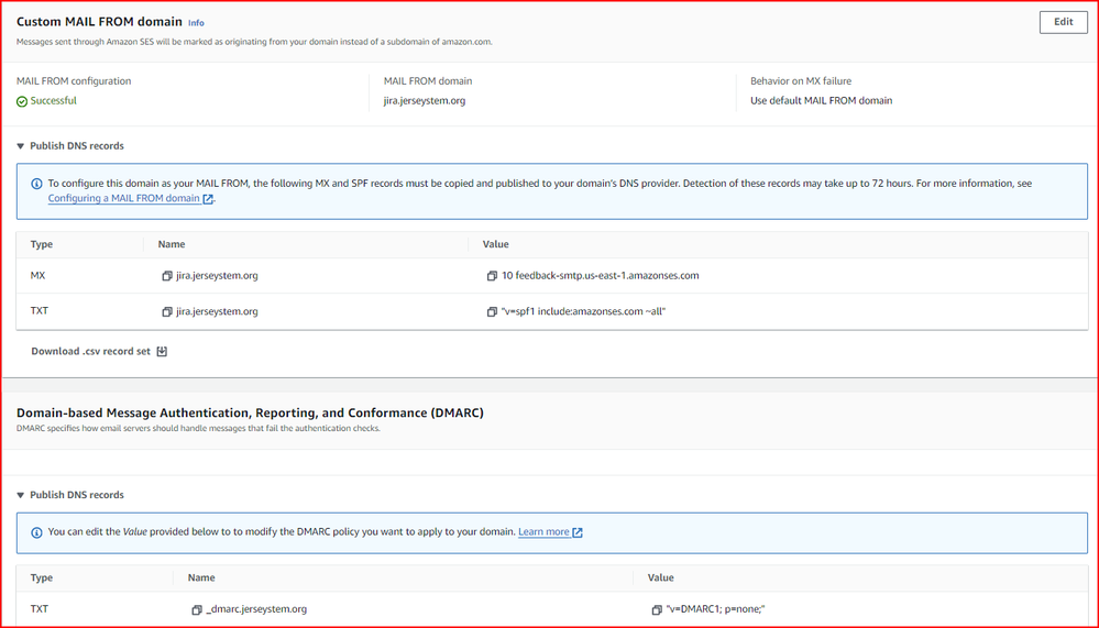

Here's what our sending Identity page looks like for the affected areas:
At this point, in may take a while for the changes to propagate through the DNS environment.  But, maybe a day later you can check on status.   Here's what you can do to check:
In AWS SES:
Find the identity you used above.  Once the information is properly propagated, you will see what we have above, specifically:
  • MAIL FROM configuration column: Successful (with a little checkmark)
  • MAIL FROM domain: your entered subdomain in item 8 in the AWS SES configuration above (recall, mine was jira.jerseystem.org)
  • Behavior on MX Failure: whatever you selected in item 9 in the AWS SES configuration discussion above.

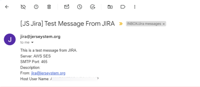

In Jira and your GMail web browser
Use the System admin function Mail | Outgoing mail to send a Test message using the associated SMTP Mail server to yourself.  When it appears in your Google Email, check to see if the phrase "via amazonses.com" no longer appears next to the From email address, as in picture below:

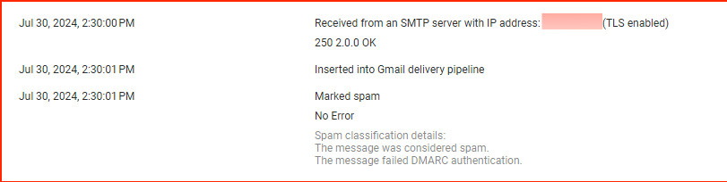

In Google:
This will get a little trickier since finding "Spam" messages are tough.   You may need to wait a few days for this test.
After about 5 days, Filter on sender = <your jira email sender, e.g., mine is jira@jerseystem.org> and use a custom date range of at least 14 days that includes a few days on either side of the date you made the DMARC change.
Then download the results to a csv file. In that file, look for receiving users who have "Marked Spam" as the event status prior to the time when you made the change and then the same user after, but as close as to as possible to, the date the change became effective.  You should see "Delivered" as event status instead.
For this test, it is possible that the user could have received the Marked Spam email, marked as Not Spam and then subsequent emails would be okay.  So it's best if you check the complete history for the email with event "Marked Spam" to make sure that the user did not subsequently change the status.  If they did not, then the subsequent "Delivered" is evidence that the DMARC change was effective.
