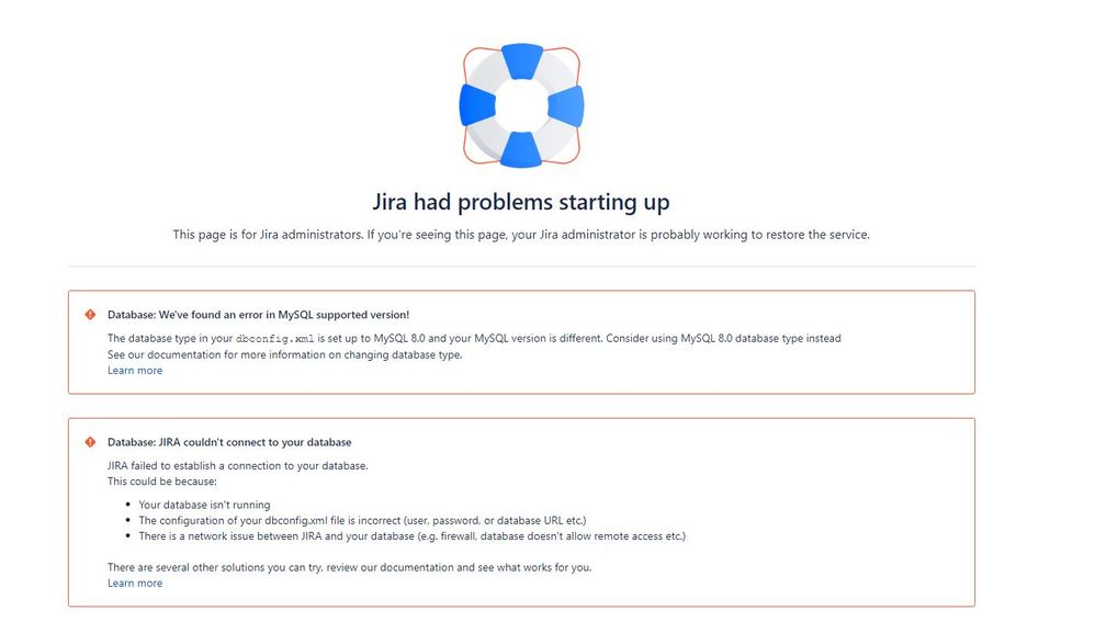

Hello,
I'm hoping someone could provide some insight on an issue we are having with our Jira installation.
We had some server downtime and after we were able to recover the server we started getting the below page after restarting the jira service.
We are using mysql 8.0.23 and we can successfully to connect via mysql workbench using the same connection string and account from dbconfig.
Server is RHEL 7 and database is running on the same server connection uses JDBC driver.
Any suggestions or advise on what is causing this issue? It was working prior to downtime with no changes to config.
Lynn Kaiser
August 16, 2021
This is a screenshot of the page we are getting after starting Jira. Including this in my question made my post too long.
Thank you!

It sounds like it was previously working before the downtime? Or was MySQL updated during the downtime?
If upgraded, validate that you have the correct MySQL 8 Connector
Lynn Kaiser
August 17, 2021
Yeah, it was working previously.
Server was failed over for 16 hours or so - we didn't start jira in the failover environment as it is non-critical.
Should be no updates after we got the servers back.
Julian Governale
August 18, 2021
Is there any additional errors in the $JIRAINSTALL/logs/catalina.out file?
You could also use the config.sh in the bin directory to try to set the Db configuration using the UI: https://confluence.atlassian.com/adminjiraserver083/using-the-jira-application-configuration-tool-976768619.html
