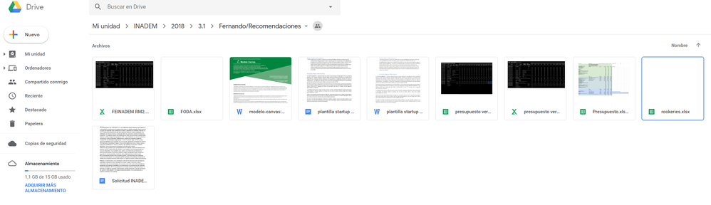

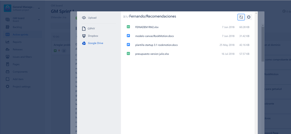

From Jira
From my Drive

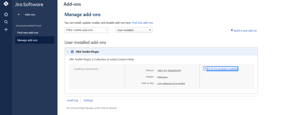

I found where to see the installed add-ons and I only have the Jira defaults
