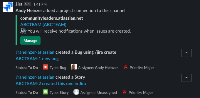

I understand that you have setup an integration between Jira and Slack, but are not seeing notifications from the Jira app in Slack when issues are created.  I tried to recreate this same problem, but when I did this I do see the notifications when Jira issues are created (both from Slack and within Jira directly).  I also didn't change any of the defaults settings here when setting up the configuration.
