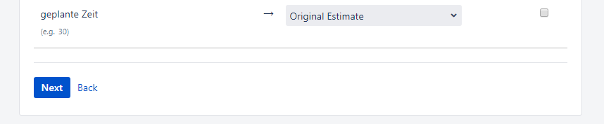

Hello together. I need help by following Problem: I upload issues from a csv-file with an estimated time (="geplante Zeit") of 30. But after the upload the estimated time isn't shown at the issue? :/

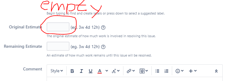

After each upload the field original estimated is empty again. Additionally i tried it with the field "remaining time" and "time spend".
I based my file on this documentation.
https://confluence.atlassian.com/adminjiracloud/importing-data-from-csv-776636762.html

The CSV i created is correctly. I only needed to add 'Time Tracking' field on the create issue screen.
This Case is solved.
