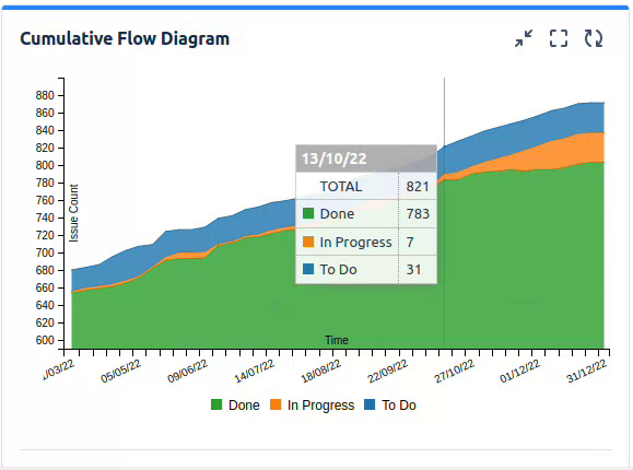

Hi @Ashima Bhatia,
You could try our Great Gadgets app. One of the many gadgets that it offers, is the Cumulative Flow Diagram (CFD) chart gadget that displays the number of issue grouped by their status.
This way you will see not only the number of issues in every status, but also the trend over time. The gadget is based on a filter of issues, so you can put all the projects in one filter or to add a chart for each project.
This app offers many other gadgets that you will find useful. If you have questions, please don't hesitate to contact us at support@stonikbyte.com.
