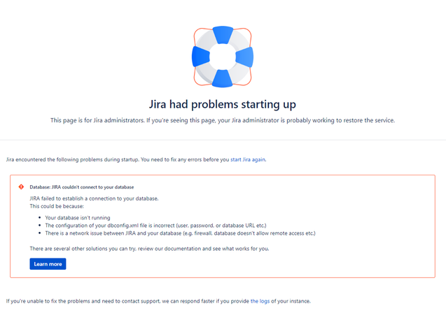

Jira couldn't connect to your database. How do I fix this after having tried several things?
Gianni S
June 16, 2019
So I've been using Jira Software (version 8.0.2) as a server on my laptop (Windows 10 Home) and it worked fine for 2 months. But now I get this screen when I try to go to my external IP:8080 or localhost:8080 or 127.0.0.1:8080.
I can ping my own external ip just fine and this works as well with localhost, 127.0.0.1 and my LAN IP.
My port 8080 is also open (port forwarded through router).
Jira is also running, firewall still has a rule for Jira Server on port 8080 to allow connection.
I do not know where the dbconfig.xml file is and I don't think that's the issue since I never touched it nor do I know where it is.
So I'm completely lost why Jira software suddenly stopped working. My last option would be to uninstall Jira and reinstall it.

It looks like you can't connect to the database

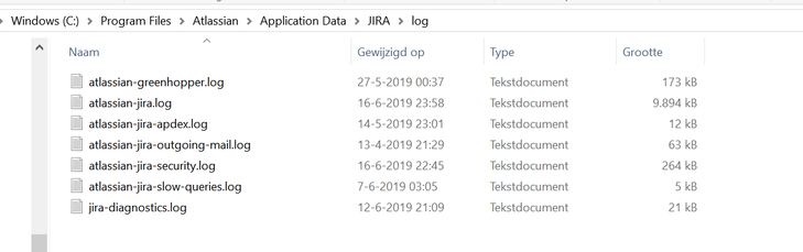

Which logs do I look at? The logs in the home directory/log show a lot of log files:

user.country : NL
user.dir : D:\Program Files\Atlassian\JIRA Software
user.home : C:\windows\system32\config\systemprofile
user.language : nl
user.name : LAPTOP-4K0CF9P6$
user.script :
user.timezone : Europe/Berlin
user.variant :
2019-06-16 23:58:20,528 JIRA-Bootstrap INFO [c.a.j.config.database.SystemDatabaseConfigurationLoader] Reading database configuration from C:\Program Files\Atlassian\Application Data\JIRA\dbconfig.xml
2019-06-16 23:58:21,182 JIRA-Bootstrap ERROR [c.a.config.bootstrap.DefaultAtlassianBootstrapManager] Could not successfully test your database:
org.h2.jdbc.JdbcSQLException: General error: "java.lang.IllegalStateException: File corrupted in chunk 240036, expected page length =< 768, got 845361200 [1.4.185/6]" [50000-185]
at org.h2.message.DbException.getJdbcSQLException(DbException.java:345)
at org.h2.message.DbException.get(DbException.java:168)
at org.h2.message.DbException.convert(DbException.java:295)
at org.h2.engine.Database.openDatabase(Database.java:297)
at org.h2.engine.Database.<init>(Database.java:260)
at org.h2.engine.Engine.openSession(Engine.java:60)
at org.h2.engine.Engine.openSession(Engine.java:167)
at org.h2.engine.Engine.createSessionAndValidate(Engine.java:145)
at org.h2.engine.Engine.createSession(Engine.java:128)
at org.h2.engine.Engine.createSession(Engine.java:26)
at org.h2.engine.SessionRemote.connectEmbeddedOrServer(SessionRemote.java:347)
at org.h2.jdbc.JdbcConnection.<init>(JdbcConnection.java:108)
at org.h2.jdbc.JdbcConnection.<init>(JdbcConnection.java:92)
at org.h2.Driver.connect(Driver.java:72)
at java.sql.DriverManager.getConnection(DriverManager.java:664)
at java.sql.DriverManager.getConnection(DriverManager.java:247)
at com.atlassian.config.bootstrap.DefaultAtlassianBootstrapManager.getTestDatabaseConnection(DefaultAtlassianBootstrapManager.java:347)
at com.atlassian.jira.config.database.JdbcDatasource.getConnection(JdbcDatasource.java:211)
at com.atlassian.jira.config.database.DatabaseConfig.testConnection(DatabaseConfig.java:88)
at com.atlassian.jira.health.checks.DbConfigurationAndConnectionCheck.doPerform(DbConfigurationAndConnectionCheck.java:60)
at com.atlassian.jira.health.HealthCheckTemplate.perform(HealthCheckTemplate.java:23)
at com.atlassian.jira.health.DefaultHealthCheckExecutor.runCheck(DefaultHealthCheckExecutor.java:74)
at com.atlassian.jira.health.DefaultHealthCheckExecutor.lambda$applyAndCollectExceptions$1(DefaultHealthCheckExecutor.java:53)
at java.util.stream.ForEachOps$ForEachOp$OfRef.accept(ForEachOps.java:184)
at java.util.stream.ReferencePipeline$2$1.accept(ReferencePipeline.java:175)
at java.util.Iterator.forEachRemaining(Iterator.java:116)
at java.util.Spliterators$IteratorSpliterator.forEachRemaining(Spliterators.java:1801)
at java.util.stream.AbstractPipeline.copyInto(AbstractPipeline.java:481)
at java.util.stream.AbstractPipeline.wrapAndCopyInto(AbstractPipeline.java:471)
at java.util.stream.ForEachOps$ForEachOp.evaluateSequential(ForEachOps.java:151)
at java.util.stream.ForEachOps$ForEachOp$OfRef.evaluateSequential(ForEachOps.java:174)
at java.util.stream.AbstractPipeline.evaluate(AbstractPipeline.java:234)
at java.util.stream.ReferencePipeline.forEach(ReferencePipeline.java:418)
at com.atlassian.jira.health.DefaultHealthCheckExecutor.applyAndCollectExceptions(DefaultHealthCheckExecutor.java:53)
at com.atlassian.jira.health.DefaultHealthCheckExecutor.performHealthChecks(DefaultHealthCheckExecutor.java:42)
at com.atlassian.jira.health.HealthChecks.executeChecksAndRecordResults(HealthChecks.java:164)
at com.atlassian.jira.health.HealthChecks.runHealthChecks(HealthChecks.java:154)
at com.atlassian.jira.health.HealthChecks.runHealthChecks(HealthChecks.java:66)
at com.atlassian.jira.startup.BootstrapContainerLauncher.start(BootstrapContainerLauncher.java:48)
at com.atlassian.jira.startup.DefaultJiraLauncher.preDbLaunch(DefaultJiraLauncher.java:117)
at com.atlassian.jira.startup.DefaultJiraLauncher.lambda$start$0(DefaultJiraLauncher.java:103)
at com.atlassian.jira.util.devspeed.JiraDevSpeedTimer.run(JiraDevSpeedTimer.java:31)
at com.atlassian.jira.startup.DefaultJiraLauncher.start(DefaultJiraLauncher.java:102)
at com.atlassian.jira.startup.LauncherContextListener.initSlowStuff(LauncherContextListener.java:154)
at java.lang.Thread.run(Thread.java:748)
Caused by: java.lang.IllegalStateException: File corrupted in chunk 240036, expected page length =< 768, got 845361200 [1.4.185/6]
at org.h2.mvstore.DataUtils.newIllegalStateException(DataUtils.java:773)
at org.h2.mvstore.Page.read(Page.java:640)
at org.h2.mvstore.Page.read(Page.java:194)
at org.h2.mvstore.MVStore.readPage(MVStore.java:1830)
at org.h2.mvstore.MVMap.readPage(MVMap.java:736)
at org.h2.mvstore.MVMap.binarySearch(MVMap.java:468)
at org.h2.mvstore.MVMap.binarySearch(MVMap.java:469)
at org.h2.mvstore.MVMap.get(MVMap.java:450)
at org.h2.mvstore.MVStore.getRootPos(MVStore.java:2227)
at org.h2.mvstore.MVStore.openMap(MVStore.java:461)
at org.h2.mvstore.db.TransactionStore.openMap(TransactionStore.java:373)
at org.h2.mvstore.db.TransactionStore$Transaction.openMap(TransactionStore.java:726)
at org.h2.mvstore.db.MVPrimaryIndex.<init>(MVPrimaryIndex.java:74)
at org.h2.mvstore.db.MVTable.init(MVTable.java:90)
at org.h2.mvstore.db.MVTableEngine.createTable(MVTableEngine.java:130)
at org.h2.mvstore.db.MVTableEngine.createTable(MVTableEngine.java:41)
at org.h2.schema.Schema.createTable(Schema.java:582)
at org.h2.command.ddl.CreateTable.update(CreateTable.java:137)
at org.h2.engine.MetaRecord.execute(MetaRecord.java:58)
at org.h2.engine.Database.open(Database.java:732)
at org.h2.engine.Database.openDatabase(Database.java:266)
... 41 more
2019-06-16 23:58:21,212 JIRA-Bootstrap ERROR [c.a.jira.health.HealthChecks] JIRA couldn't connect to your database
2019-06-16 23:58:21,212 JIRA-Bootstrap ERROR [c.a.jira.health.HealthChecks] JIRA failed to establish a connection to your database.
This could be because:
- Your database isn't running
- The configuration of your dbconfig.xml file is incorrect (user, password, or database URL etc.)
- There is a network issue between JIRA and your database (e.g. firewall, database doesn't allow remote access etc.)
There are several other solutions you can try, review our documentation and see what works for you.
2019-06-16 23:58:21,215 JIRA-Bootstrap INFO [c.a.jira.startup.JiraStartupLogger] Running JIRA startup checks.
2019-06-16 23:58:21,215 JIRA-Bootstrap FATAL [c.a.jira.startup.JiraStartupLogger] Startup check failed. JIRA will be locked.
2019-06-16 23:58:21,389 JIRA-Bootstrap INFO [c.a.jira.startup.LauncherContextListener] Memory Usage:
Heap memory : Used: 75 MiB. Committed: 362 MiB. Max: 2027 MiB
Non-heap memory : Used: 43 MiB. Committed: 66 MiB. Max: 1536 MiB
TOTAL : Used: 118 MiB. Committed: 428 MiB. Max: 3563 MiB
