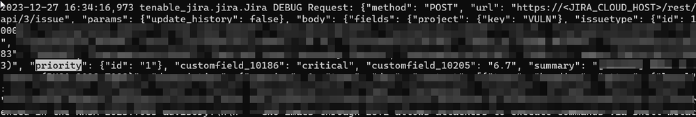

I have this same issue.  No response?  Debug shows it's trying to set priority to "id':1", which should be valid to the best of my knowledge.
2023-12-27 16:34:17,276 restfly.errors.BadRequestError ERROR [400: POST] https://<JIRA_CLOUD_HOST>/rest/api/3/issue?update_history=False body=b'{"errorMessages":[],"errors":{"priority":"The priority selected is invalid."}}'
