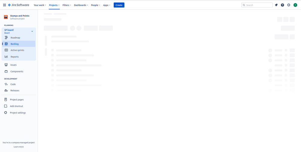

Hi community,
I have created new free trial Jira instance recently and my first project there. I am able to create issues there, but my boards like Backlog/Active sprints/Roadmap are not loading in UI. Please see the screenshot.board_is_not_loading.png
The issue is not gone after a few hours. I have tested it on three browsers (Firefox, Chromium, Chrome) in both incognito and common modes. Also I have tested it on my phone in browser version. None of the above helped.

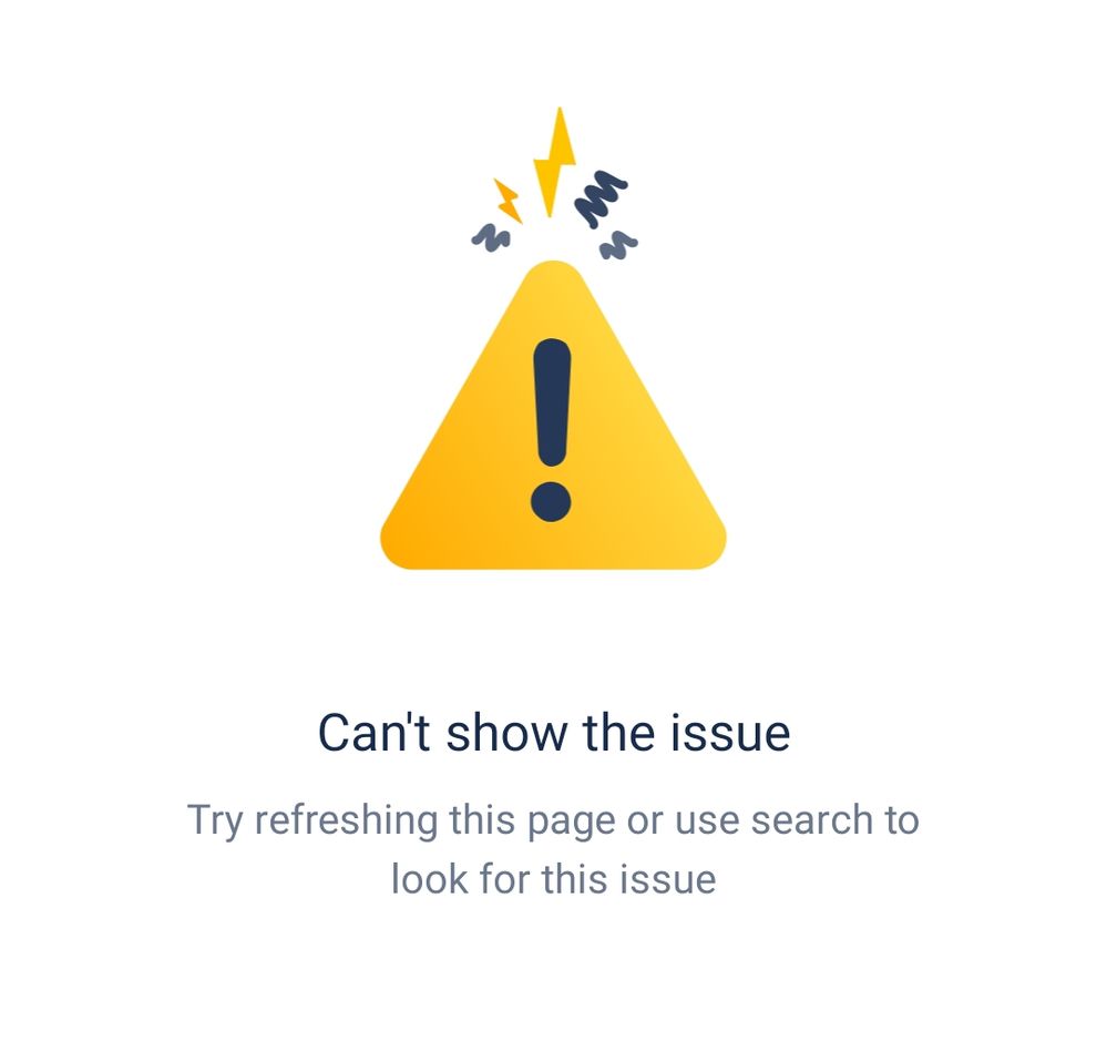

In the phone app by the way I am also not able to open issues with this error.
(not sure if these issues are related or not)

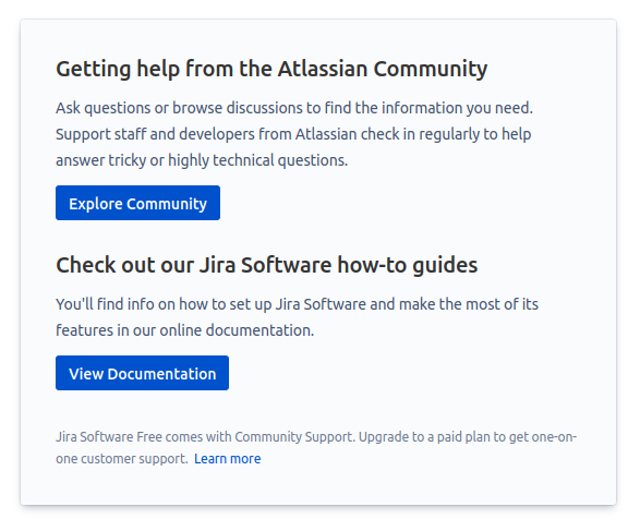

I would contact them if I could, but as I understood they do not provide support for "Free Trial" versions of Jira. If I go to
https://support.atlassian.com/contact/#/
It says:
Jira Software Free comes with Community Support. Upgrade to a paid plan to get one-on-one customer support.
That is why I came here with this question. Or am I doing something wrong and in fact Atlassian Support can help me in some way?

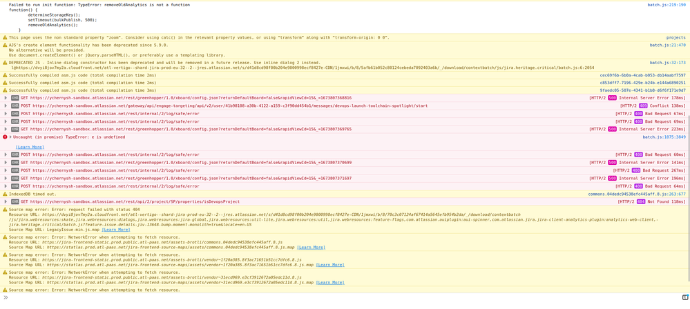

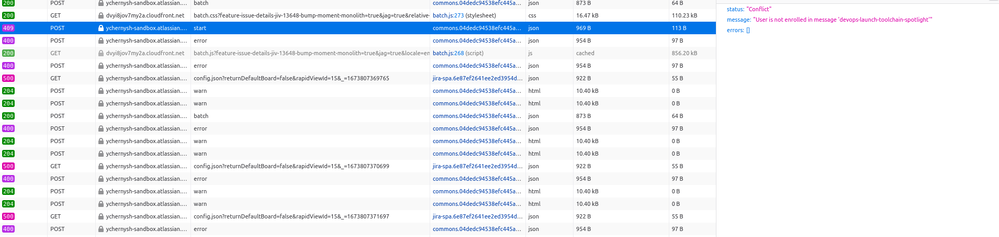

Okay, so I think you should try something.
Open the browser web console when accessing Jira and check if any error from the console logs,  also check the network and check if any failed requests?
Yaroslav
January 15, 2023
@Tam _DevSamurai_ok so there are actually some warnings, errors and 4XX and 5XX responses.
0. Failed to run init function: TypeError: removeOldAnalytics is not a function function() { determineStorageKey(); setTimeout(bulkPublish, 500); removeOldAnalytics(); }
1. {"errorMessages":["Internal server error"],"errors":{}}
2. {"status":"Conflict","message":"User is not enrolled in message 'devops-launch-toolchain-spotlight'","errors":[]}
3. {"errorMessages":["Invalid request payload. Refer to the REST API documentation and try again."]}
4. Uncaught (in promise) TypeError: e is undefined
5. IndexedDB timed out.
6. {"errors":{},"errorMessages":["The property isDevopsProject does not exist."],"httpStatusCode":{"empty":false,"present":true}}
7. Source map error: Error: request failed with status 404
8. Source map error: Error: NetworkError when attempting to fetch resource.browser_console.pngbrowser_network.png

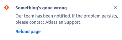

@Tam _DevSamurai_also when I try to open Roadmap, I see this:
Something's gone wrong
Our team has been notified. If the problem persists, please contact Atlassian Support.
