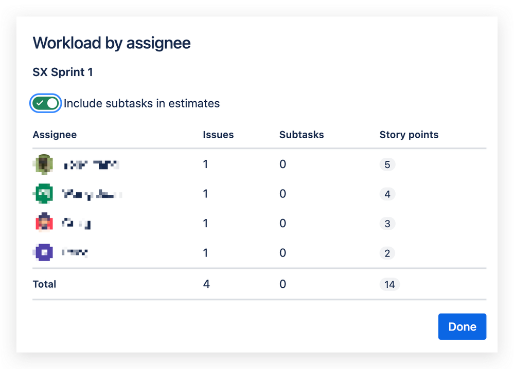

Yes, the current "Workload by assignee" report doesn't include time estimates, which is not a bug. What you're expecting is a new function point to Jira product. I think you could raise a ticket to Atlassian support to request this feature.

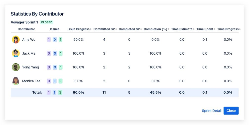

If this is key function to your team, maybe you could have a try of Jira Apps like Sprint Reviewer Pro as follows:

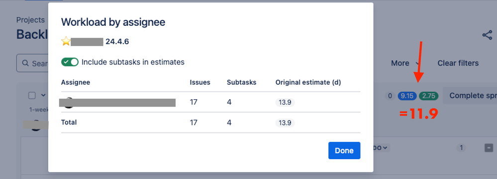

I am not looking for current work by assignee. I am looking at the overall totals on the backlog sprint planning board. Why is the overall total missing the sub-task values.
We have to option to create a separate task if the sub-task is separate from the parent issue. You are rationalizing the way the Atlassian supplied view works. I can see the correct total on a Structure Board. Please, see my response to Shabeer Ahmed.

Why does the Jira backlog sprint planning board totals not take into account the sub-task values? Is that a bug?
I believe so (even if you enable including sub-tasks in estimations). Here's one reported Bug that might be relevant: JSWCLOUD-26713: Enabling the 'Include Sub-task in estimations' does not change the estimated time in the planning information.

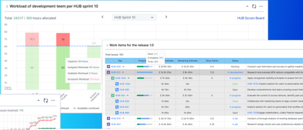

Unfortunately there's no setting to enable the sum-up of Subtasks estimates you're looking for in Jira Cloud. If I understand your final goal properly, you'd like to be able to view and aggregated number of hours per Sprint per user to understand their capacity.
If that's the case, you can evaluate a Workload per Sprint (WPS) report from the app we've built: Report Hub - Custom Charts, Reports & Timesheets for Jira
Here's a quick preview of WBS and WPS reports I think might be a good fit due to aggregating estimates (hours & story points as well as other numeric values) and highlighting overloaded / underloaded team members:
