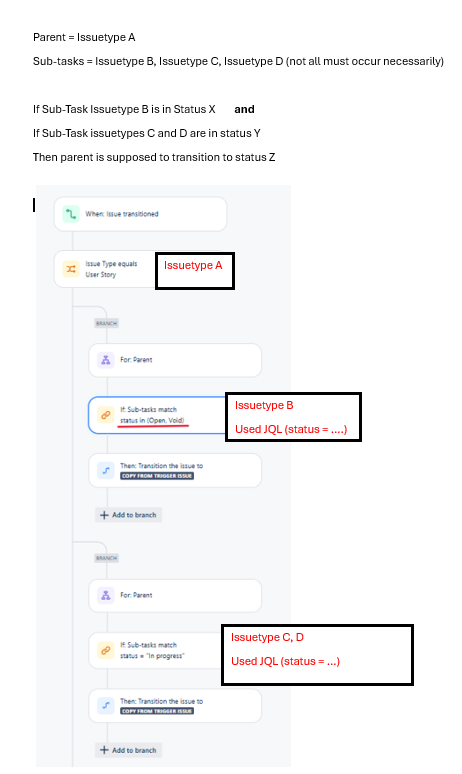

Hi all,
could please someone bring me on the right track how to proceed with the automation described in the annex.
Your advices and ideas are really appreciated.
Thank you, Anette
3 answers

Anette Noll
April 17, 2025
Hi @Bill Sheboy ,
thanks for reminding me to be more precise.
Project-type
= company-managed
This is to be achieved
= if parent is in a certain status and all subtasks are in defined status,  parent transitions automatically to next status
Initial Conditions:
parent work item is of Issue Type A
parent work item is in Status Z0 (status before Status Z)
The parent work item has zero-to-many sub-tasks of Issue Types B, C, and D
Trigger:
One of the sub-tasks of any type transitions status …
Conditions:
And all sub-tasks of Issue Type B are in Status X
And all sub-tasks of Issue Type C are in Status Y
And all sub-tasks of Issue Type D are in Status Y
Action:
Then transition the parent work item to Status Z
I hope this explanes better what I am trying to achieve.
Thanks for your time.
Best regards, Anette
Bill Sheboy
April 17, 2025
Thank you for clarifying the scenario.  There is a template in the rules list you could start with named:
When all sub-tasks are done → move parent to done
With that as a starting point, you could change the Related-Issues Condition to use JQL (rather than just checking the subtasks), and then copy it so both subtask cases are covered.
As an example, and assuming the rule branches to the parent, the JQL for the first condition could be:
parent = {{issue.key}} AND issueType = "Type B" AND status != "Status X"
Please note I inverted the condition to test the status is not equal, and then the rule condition would check that None Match Specified JQL.  Do the same thing with another condition for testing the other sub-task types.
Please try creating that rule and let us know what you find.  Thanks!

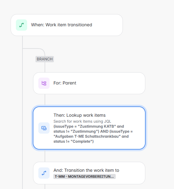

Anette Noll
April 22, 2025
Hello @Bill Sheboy
Thank you for your response.
To be honest I don't quite understand your approach with the inverted condition, due to my little experience with automation.

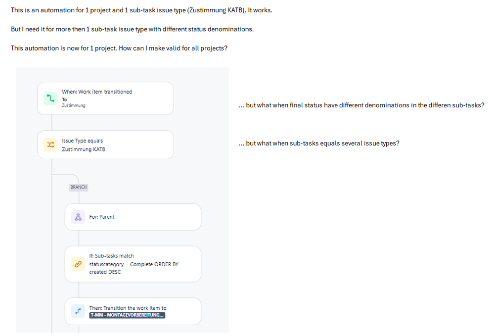

What I have done is to start with the template you recommended and tried a lot of combinations.
It works for one sub-task type, but not for more. What is wrong with this?

Bill Sheboy
April 22, 2025
Please show an image of the audit log details, with all of the areas expanded, to show which rule steps happened.
As written, your rule will stop when any condition is not met.  Have you confirmed the Status values you are using in the JQL conditions for each subtask type are correct?

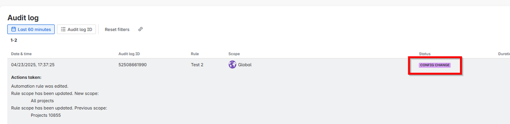

Anette Noll
April 23, 2025
Hello @Bill Sheboy
I just made another attempt and then had a look on the audit log.
However, this information does not gives any insight into the problem. It seems that this automation is not running at all, although it is enabled.
Bill Sheboy
April 23, 2025
The entry you show is for a rule edit, not an execution.
Please transition an issue to trigger the rule, check the results, and then post the image of the audit log details showing the rule execution.

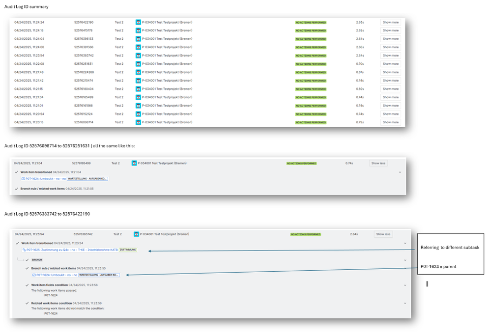

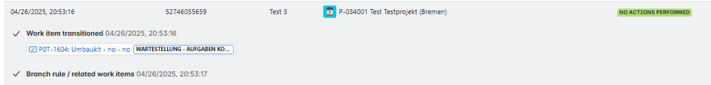

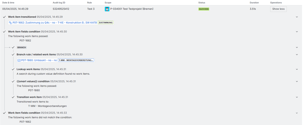

Anette Noll
April 24, 2025
Hello @Bill Sheboy ,
here a comprised screenshot with two different kinds of messages.

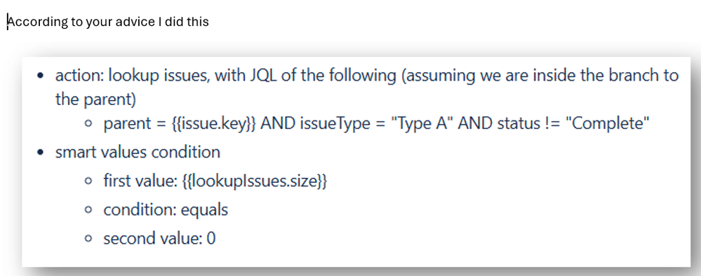

Bill Sheboy
April 24, 2025
Thanks for those images, and...
Because there could be zero-to-many subtasks, the built-in related issues condition with JQL may not help because it will fail when there are no subtasks.  Instead, you may need to use the Lookup Issues action with JQL (inverting the test as I noted earlier) and checking for no results.
For example, you want all of the subtasks of a certain type (if there are any) to all be "completed" before proceeding.  And so we could check that none are not completed:
  • action: lookup issues, with JQL of the following (assuming we are inside the branch to the parent)
    • parent = {{issue.key}} AND issueType = "Type A" AND status != "Complete"
  • smart values condition
    • first value: {{lookupIssues.size}}
    • condition: equals
    • second value: 0
Those two steps would take the place of the condition on the subtask for "Type A", and would would be repeated to test the other subtask type using different JQL.

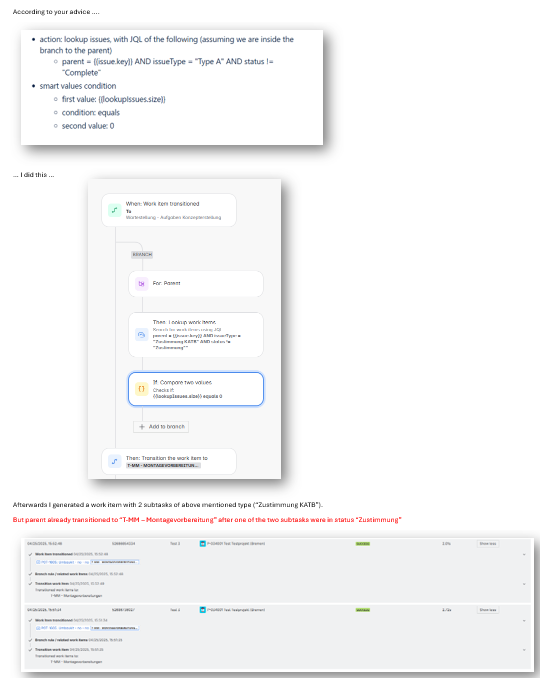

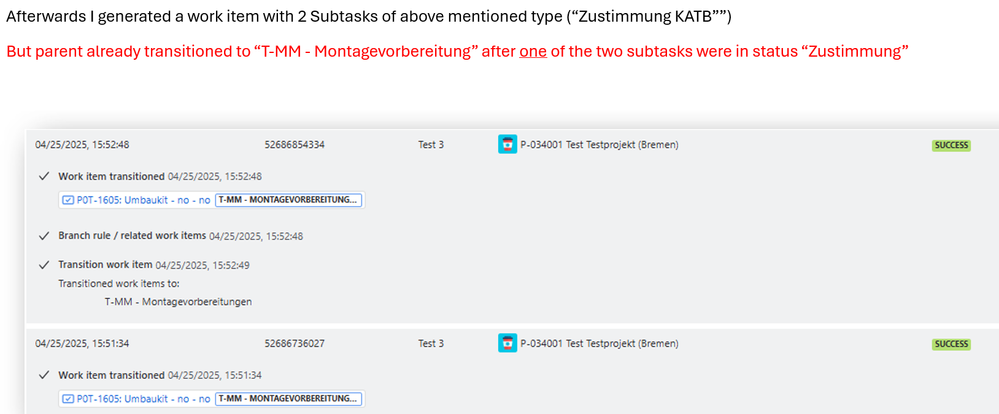

Anette Noll
April 25, 2025
Hi @Bill Sheboy
please see my experience:

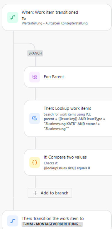

The transition action needs to be inside of the branch and after that condition.  Please drag-and-drop it below the condition and then re-test.
Finally, your current rule only tests one subtask type.  Do you want to still test both types?
Anette Noll
April 26, 2025
I corrected position of transition action and then re-tested just the same scenario:
2 sub-tasks of same issue type.
I transioned both sub-tasks to status "Zustimmung", but this time parent status did not change.
As to your question concerning the other 6 sub-task issue types .... doesn't it make sense to wait testing them until automation for at least one issue type works?

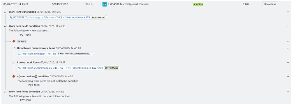

Bill Sheboy
April 26, 2025
Yes, I does make sense to get one type working first.
Please expand the audit log details to show everything by expanding the arrows at the right side of the log.  That will show what else happened as the current image just stops at the start of the branching.
Anette Noll
April 26, 2025
It has already been completely expanded; no arrow or possibility to expand with the branching rule:
Bill Sheboy
April 27, 2025

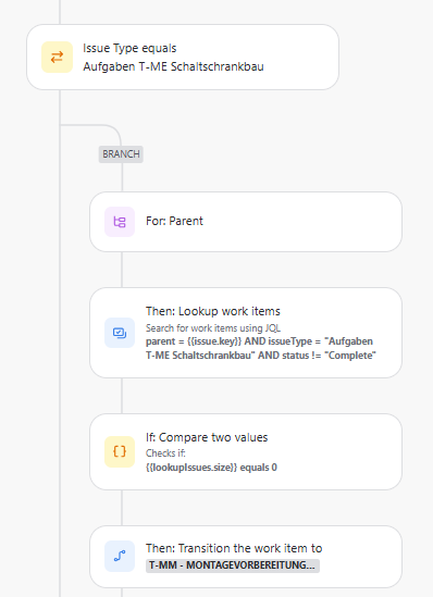

Based on what you show, the trigger issue POT-1604 has no parent issue.
I suspect you only want this rule to run when the trigger issue is one of your subtask types, and so after the trigger add an Issue Fields Condition to check that the Issue Type is one of your types:
  • trigger: issue transitioned...
  • condition: issue type is one of your list of subtask types
  • branch: to parent

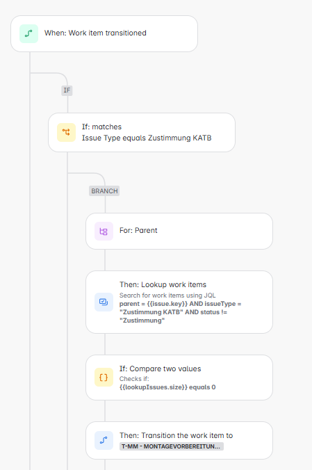

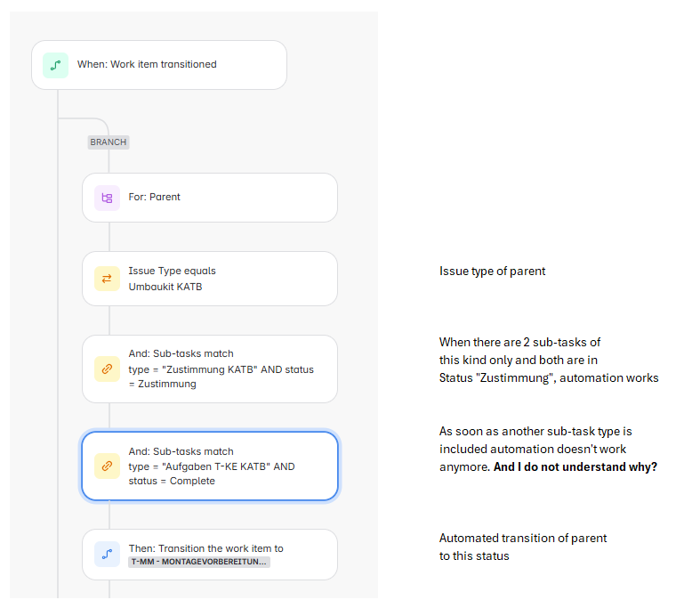

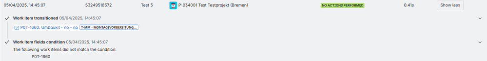

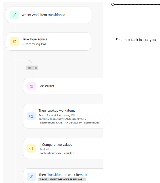

Anette Noll
April 28, 2025
great .... after all it works with 1 sub-task type.

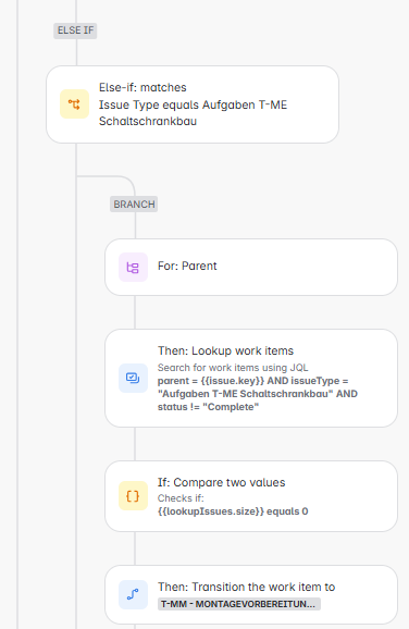

After that I added another condition with another issue type, branched it to the parent, updated jql.
Test 1:
After transitioning all items of the first sub-tasks type (not the second issue type), parent already transitions
Test 2:
Transitioning all items of the second sub-task typ, parent does not transition;
only after transitioning the first sub-task type
Bill Sheboy
April 28, 2025
That sounds correct, based on the rule you show now.  Do you agree?
The final steps would be:
  • add the other subtask types in that new condition after the trigger
  • adding another lookup issues and condition check for the other subtask type inside the branch

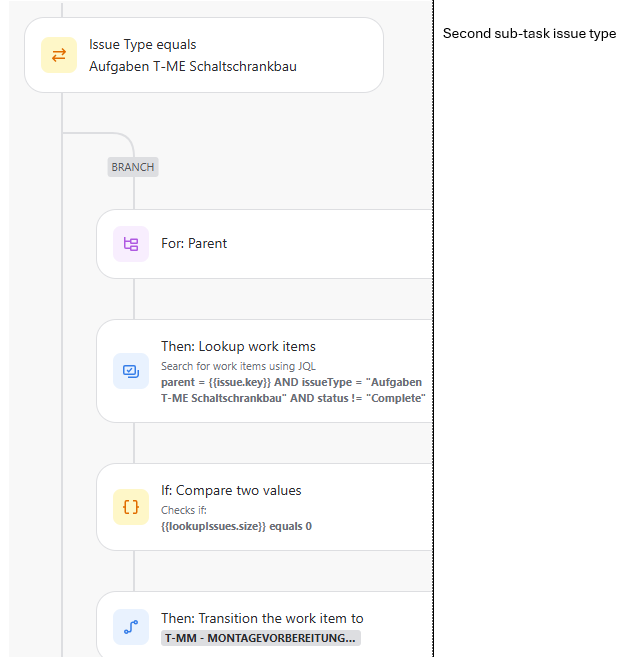

Anette Noll
April 28, 2025
what I wanted to say is, that I added another condition after the trigger for a second sub-task type.
But it doesn't work for the second subtask-type, only for the first one.
Test-scenario:
new workitem only with 2 sub-tasks of second type, both in status "complete", but parent does not transition.
The audit log shows No actions performed

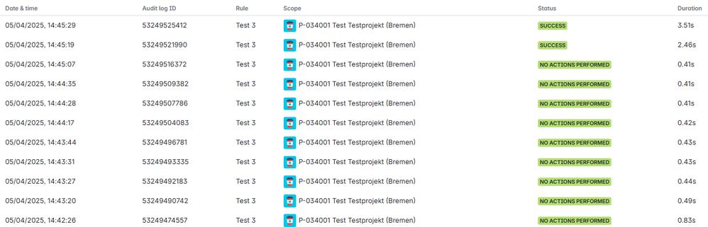

Bill Sheboy
April 29, 2025
Please post an image of your current complete rule and of the audit log details from that last rule execution (with all of the details expanded).  Thanks!
Anette Noll
May 4, 2025
please receive as requested.
Log ID 53249509382 is identical to the following 7 logs, therefore I included it here only once.
Bill Sheboy
May 4, 2025
Thanks for the rule image as that explains the problem:
When a condition is not met, a rule stops processing.  When you want multiple different conditions to be checked AND the rule to continue for each, please use the if / else block with the conditions.
For example:
  • trigger: work item transitioned
  • if / else block with condition: issue type is the first subtask type
    • branch: to parent
      • action: lookup issues for that type
      • smart values condition to check none were found
      • action: transition the issue
  • else / if (continuing the above block): issue type is the second subtask type
    • branch: to parent
      • action: lookup issues for the other type
With your current rule, you may add the if / else after the trigger and then drag-and-drop the branches inside to adjust the rule.

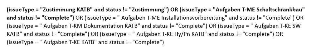

Bill Sheboy
May 8, 2025
I hope you enjoy your holiday and time off!

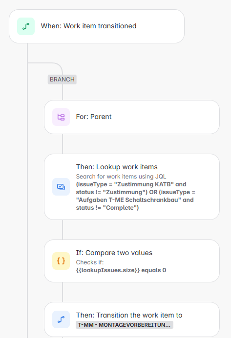

When you return, let's consider how to combine the conditions as you want BOTH of the subtask type checks to succeed.  That may be done by combining the tests in a single JQL expression.
  • branch: to parent
    • lookup issues: the JQL should span both possible subtask cases
The JQL for the lookup could be this.  Please review and update it as needed.
AND (
(issueType = "Zustimmung KATB" and status != "Zustimmung")
OR (issueType = "Aufgaben T-ME Schaltschrankbau" and status != "Complete")
Anette Noll
June 5, 2025
Hello @Bill Sheboy
thanks for this new attempt.
I just updated automation and the JQL for the lookup according your recommendation:
AND (
But again .... after first subtask-type is in status "Zustimmung" parent transioned into next status although second subtask type was not in status "complete".
After that I changed JQL for look up (AND instead of OR):
(issueType = "Zustimmung KATB" and status != "Zustimmung") AND (issueType = "Aufgaben T-ME Schaltschrankbau" and status != "Complete")
But just the same.
Bill Sheboy
June 5, 2025
Please review my earlier suggestion as your rule is missing the condition after the lookup and before the transition:
  • smart values condition:
    • first value: {{lookupIssues.size|0}}
    • condition: equals
    • second value: 0

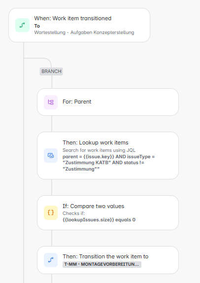

Anette Noll
June 6, 2025
Hello @Bill Sheboy
now it is working as expected!!
I only must add the other subtask types to the Lookup work items.
Thank you again for your expertise and patience!
Like Bill Sheboy likes this
I am sorry but I have to come back to may issue.
Today I extended the lookup with the missing 4 subtask types and again it does not work. No other changes made.
With the bold part it worked, after the extension it doesn't.
Could you please advise if there is anything wrong with this termin (I checked correct writing of subtask-types) or is there any quantative restriction I have to keep in mind?
Bill Sheboy
June 11, 2025
I see some spaces before your status names for the updated JQL.  Have you tried removing those spaces?
As a tip: I recommend testing JQL outside of a rule first, perhaps with example work items / issues.  Once it works as expected, copy it into a rule for further testing.
Anette Noll
June 12, 2025
Hello @Bill Sheboy
yes, I did so .... testing JQL outside of rule. There it works fine.
Bill Sheboy
June 12, 2025
Just to confirm, did you remove the extra spaces from the JQL in the rule?
Anette Noll
April 16, 2025
Hi Carol,
just tested what you described and serveral other ways as well, but parent does not transition.
 In the screenshot below I described what I did. Would be great if you could have another look at it, what may be wrong with this.
Thank you!
Regards, Anette

Carol Lage

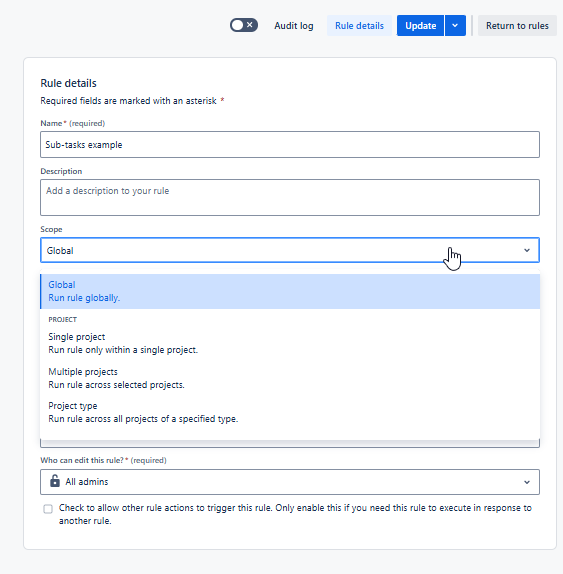

April 10, 2025
Hi Anette,
Looking about your problem, I don't know if I understand the different scenarios you have with your sub-tasks, but you can try this:
1. You can add a branch for each situation you have different denominations that will proceed with different outcomes. If you have different status doing the same thing on rule, you can use the JQL to group the status you want like Status in (Status1, Status2), like in the screenshot.
2. To set the rule for all projects, click on Rule details > Scope, and change the field to global (you have to be an admin to choose it) > Turn it on/Update.
Also, check this documentation about branching that can be useful in your case - Jira automation branches | Cloud automation Cloud | Atlassian Support
I hope this helps, and please let me know if it works or if you need to discuss it further.

Carol Lage
May 6, 2025
Hi Anette,
Glad that Bill was able to understand and support you.
Hope that setting the rule as global also worked.
Regards,
Carol
Anette Noll
June 6, 2025
Hi Carol,
finally problem is solved.
Also thanks to you to advise me with the rule as global!
Like Carol Lage likes this
