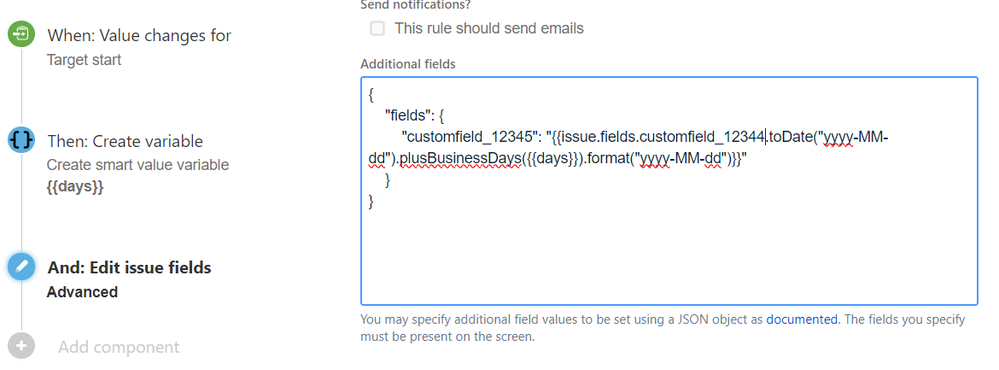

I am trying to set Target End using jira automation based on the value of Story Points(1 story point = 1 business day).
So I am creating a smart value variable named days as below:
{{#=}}CEILING({{issue.Story Points}} + 1){{/}}
Then I am trying to set Target Date using JSON Object. When I dont use days variable, just passing number to plusBusinessDays function is working. But when I try to use days variable, it is not working.
My Automation rule looks like below:

Try removing the curly braces that you have around days in your JSON code, such that it becomes
...plusBusinessDays(days)...
Chaya
August 28, 2024
@Trudy P Claspill  I tried that, it is not working. It is giving me Unparseable date: "" error

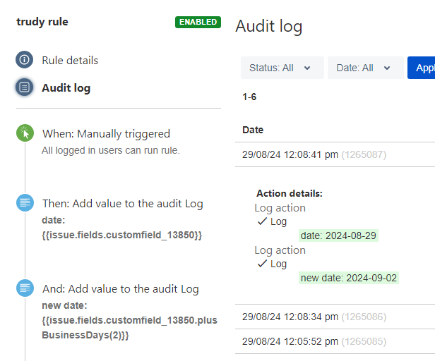

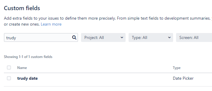

I have done my own test on Jira DC 9.4.11. For me the function works correctly when I use it with a custom field of type Date Picker
Screenshot 2024-08-29 at 12.09.07 PM.pngScreenshot 2024-08-29 at 12.10.13 PM.png
Perhaps there is a typo within your rule. Perhaps the field is not the Date Picker field type.
