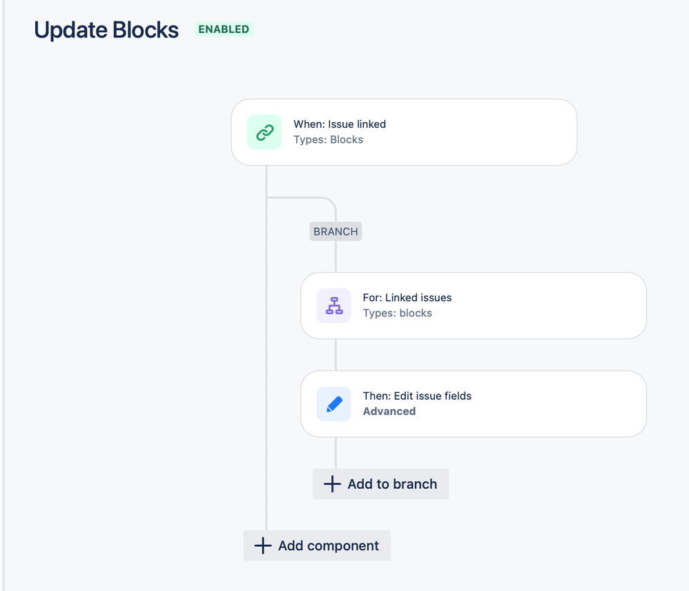

  1. Create a custom checkbox field
  2. Create an Automation to flag an issue block. This runs on the blocking issue.
    1. Trigger = Issue linked for type: block
    2. Branch: Linked issues of type blocks
    3. Edit issue field for the new checkbox to be true (will have to use the advanced json section to update)

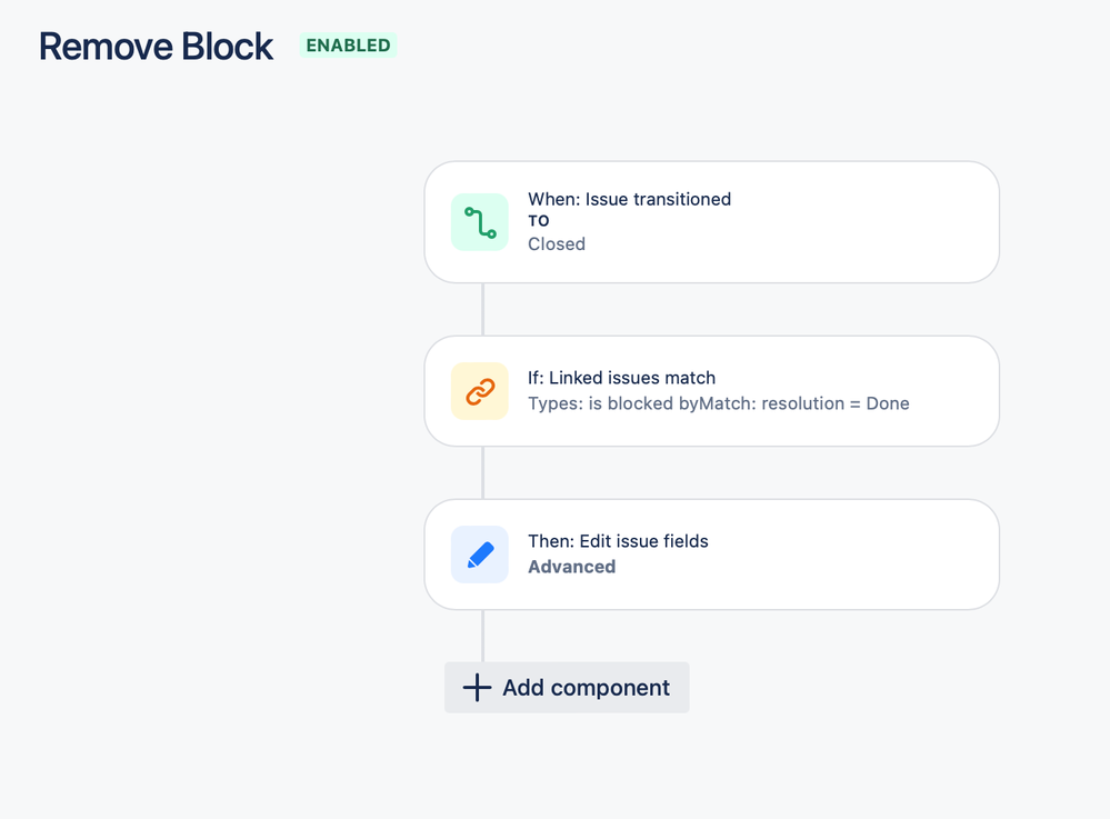

  3. Create and automation to remove issue block. This runs on the issue that's transitioning.
    1. When: Issue transitioned to Done
    2. IF: Linked issues match JQL (you. may need to edit jql to match what you define as "done", but I've used "resolution = Done"
    3. Then: Edit issue fields (use JSON to update the custom field to false).
  4. Use a validator on the workflow that references the custom checkbox field to determine if this can transition.
Screenshot 2024-10-07 at 12.02.58 PM.pngScreenshot 2024-10-07 at 12.09.28 PM.png
