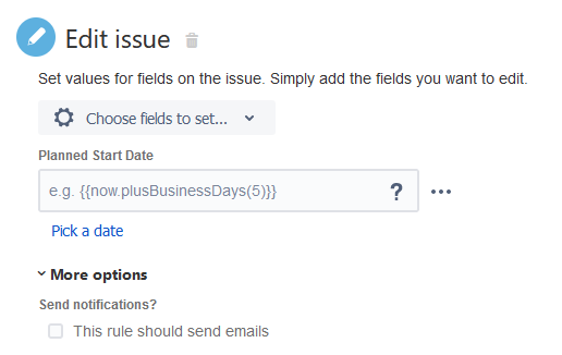

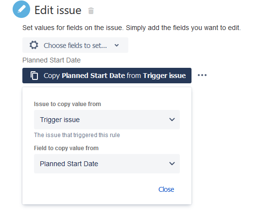

What actually would have helped a lot, would be if I could look at the code behind the things that you can choose within the GUI. E.g. in the screenshot below, I'd like to know what the fields are doing in code. I would have been able to copy/paste the lookup function for the trigger issue planned start date. Is there a way to check this code?

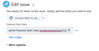

Try using this for the Planned Start Date field in the Edit Issue:
{{issue.parent.Planned Start Date.plusBusinessDays(8)}}
It's case sensitive so be sure the field name is exactly the same.

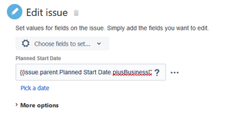

Here's the input for the edit Issue:

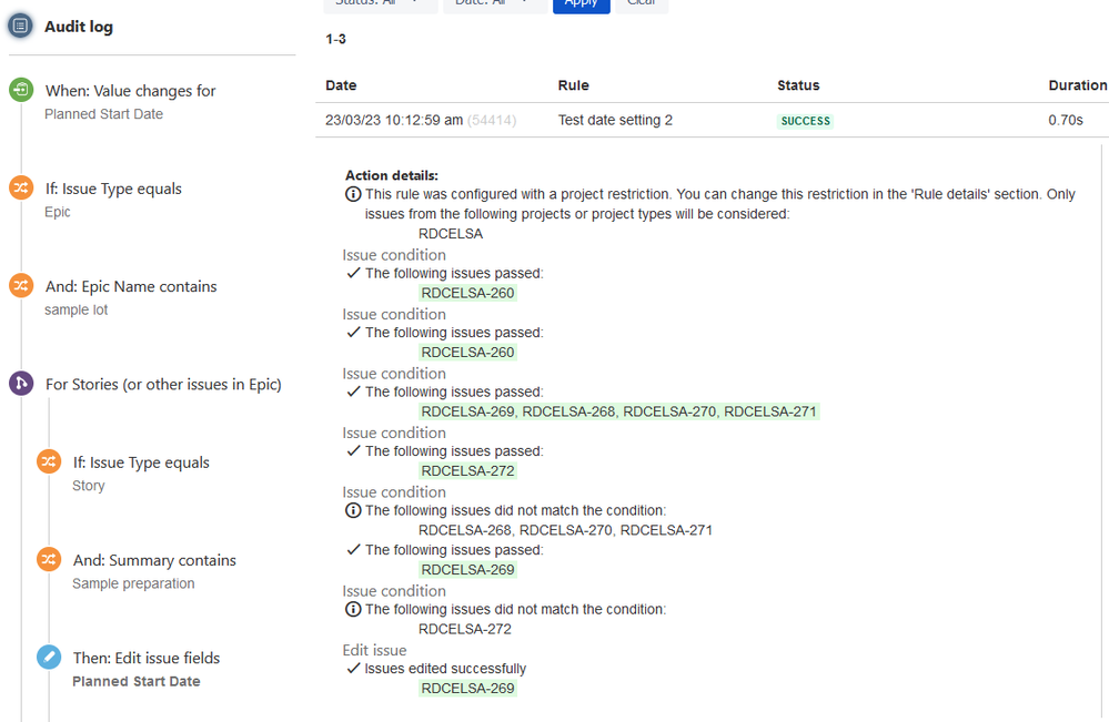

According to the rule audit log, it triggered correctly, chose the correct story out of the 5 available and edited the Planned start date. However, I can't see that change. (I guess I can kill the filter looking for stories. seems obsolete)
260 is the parent epic, 268-272 are the stories.
Resulting "input" in the planned start date field: none

However it apparently works to lookup and copy/paste the unaltered date. Can we somehow look at the code behind this GUI controlled command so that I could copy it and add the date-shift?

I tried to look at the code behind the GUI shown above (also works as advertised), but could not find something that I would identify as the lookup function. I guess this is hidden deeper within the code library.
