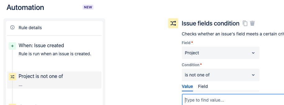

Trudy P Claspill
May 2, 2023
Hello @Kavi
What is the trigger for these rules? Is it using the "Issue Created" trigger?
I would recommend putting an Issue Fields Condition after the trigger of each rule so that each rule will run only when the create issue is NOT ONE OF the projects handled in the other rule.
Kavi
May 2, 2023
Hi @Trudy P Claspill
Yes, trigger was "Issue Created".
Great, thank you so much for your response.
It works as expected now.
