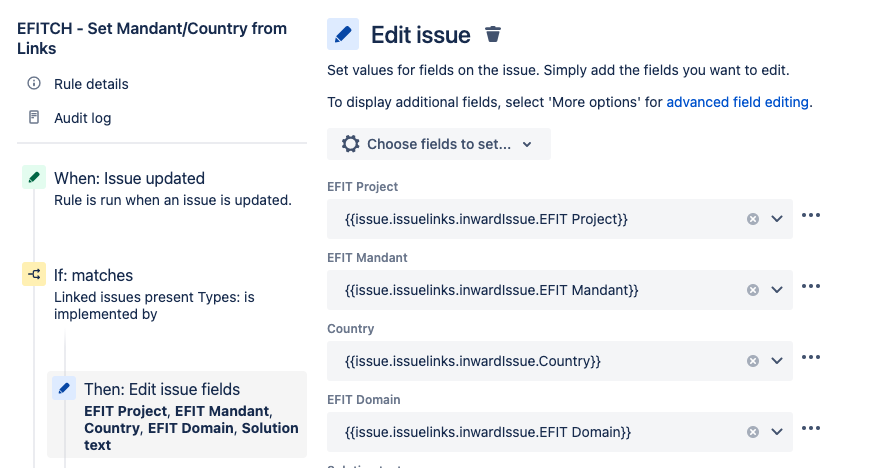

We have a use case very we need to inherit certain custom field values from the
link type is implemented by
We use the smart value   {{issue.issuelinks.inwardIssue.CUSTOM_FIELD}}
which provide the values for all inward links but I need to extract only the values for
How can this be done ?
Here is the current automation rule:

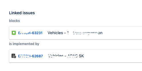

The trigger and link extraction direction is all  clear and works well with a single link.
The issue is  when we have multiple links on the same issue, then   {{issue.issuelinks.inwardIssue.CUSTOM_FIELD}} is returning the values for all links and there is no way to know which value comes from which link type
in the described scenario where we have 2 link types (blocks/Implements) we receive
Country custom field value: SK-Slovakia,CH-Switzerland
and we don't know which value belongs to which link type

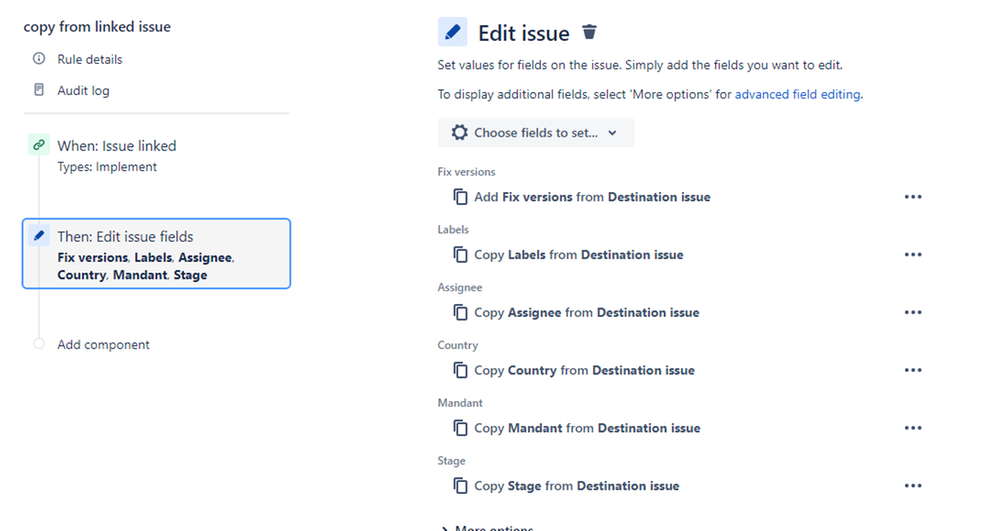

As you mentioned your trigger works: did you also think of the trigger "Issue linked"?
  • With this trigger the rule could listen for a certain link type (in your case "implements/is implemented by").
  • With the inward/outward relation this automatically provides the destination and source issue.
  • You could then automatically do a "copy from destination issue".
Might that be a feasable way? What do you think?

Hi @Stefan Salzl  thanks for your effort and example
It looks like its is currently not possible to retrieve the values for a particular link type when multiple links exist.

Hi @Peter Reiser ,
if the link you provided here is the same you are looking for then I got you completly wrong.
My understanding was:
  • There is an Epic A
  • Story B --> "implements" Epic A
  • Story C --> "implements" Epic A
  • Story D --> "blocks" Epic A
  • field values from Epic should be inherited to linked issues but only to those linked with "implement/implemented by"

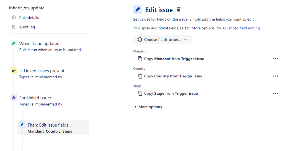

As I got it right here please see my screenshot with the "Issue updated" trigger. I tested it on my site with having different link types in one epic and only those with the "implement" link have been updated.
Best
Stefan

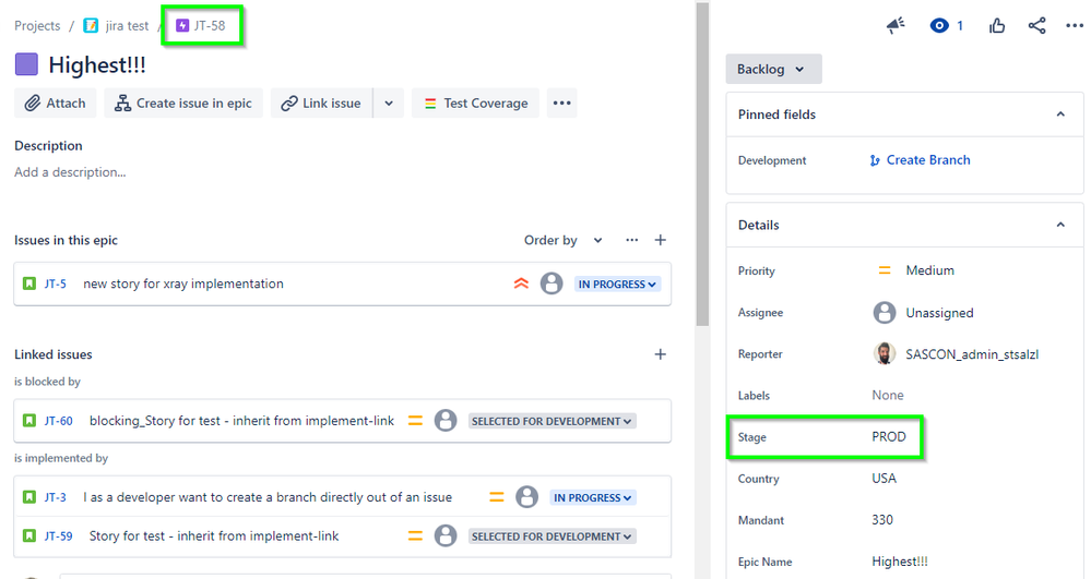

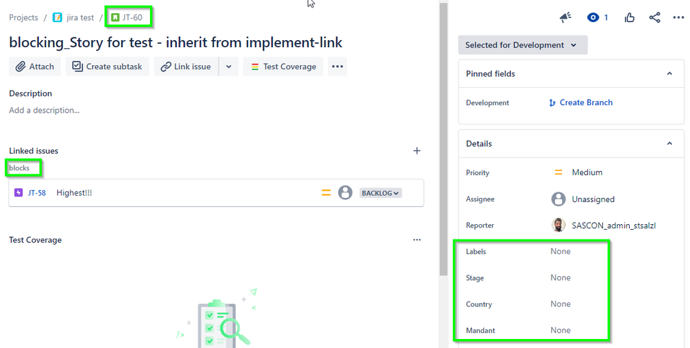

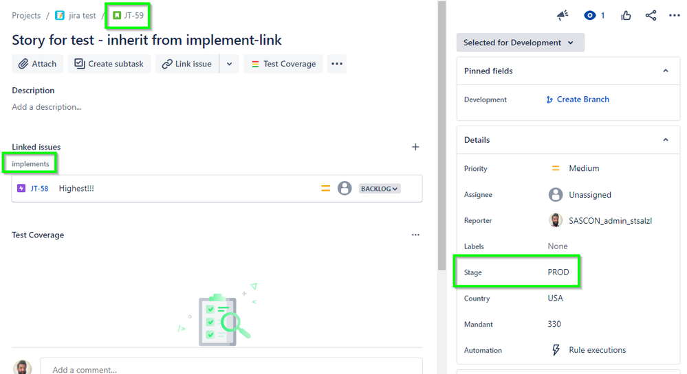

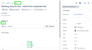

Stefan Salzl
February 12, 2022

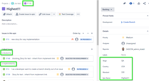

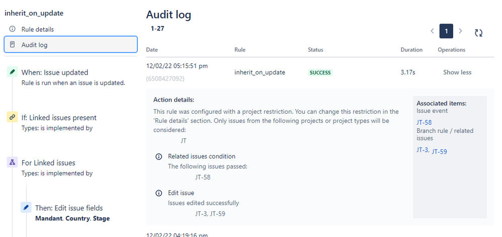

Before change:
After changing Field "Stage" in EPIC (and automation rule):
  • no changes made in "blocks" linked issue
  • changes inherited to issues with "implements" link
  • audit log of automation rule shows changes/changed issues (the changed issues are those linked with "implement")

So that means with  {{issue.issuelinks.inwardIssue.CUSTOM_FIELD}} we get all the values for all the link types:
e.g.  Country custom field value: SK-Slovakia (from link blocks), CH-Switzerland (from link is implemented by )
and we can't just pull the value for the link type is implemented by  (CH-Switzerland)
