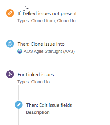

Please see screenshot attached.

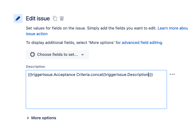

If so then you could try something like this:
Screenshot 2023-10-12 at 10.46.19 AM.pngScreenshot 2023-10-12 at 10.48.34 AM.png
{{triggerIssue.Acceptance Criteria.concat(triggerIssue.Description)}}

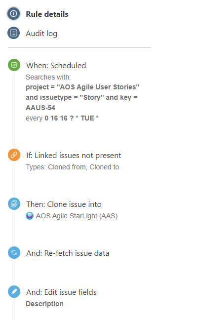

Hi Trudy, I tried that and the rule completed successfully, however on the cloned ticket I am getting the following:
Both Criteria and Description fields are multi-line text fields.
Action details:
This rule was configured with a project restriction. You can change this restriction in the 'Rule details' section. Only issues from the following projects or project types will be considered:
AAUS
Related issues condition
The following issues passed:
AAUS-51
Clone issue
Issues cloned successfully
AAS-42
Re-fetch issue data
Issue data re-fetched from server successfully.
Branch rule / related issues
No related issues could be found.
The new cloned ticket did not concatenate the 2 fields together into: Description field.
Please kindly advise.

You have changed the rule so that the Edit is no longer being applied to the "For: Linked Issues" branch. That was not part of the solution I described.
The Edit needs to remain contained within the "For: Linked Issues" branch.

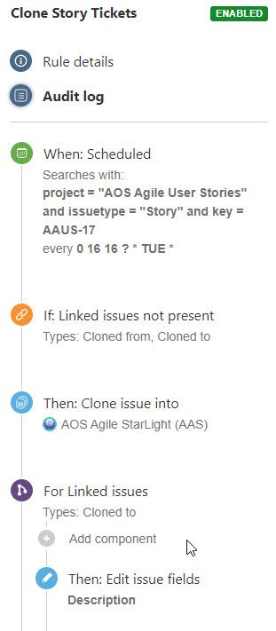

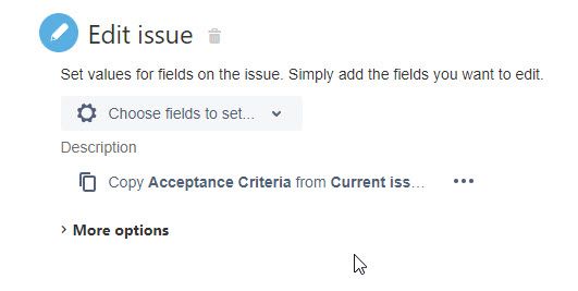

For the Edit, I must be doing something wrong.  I have this in the rule which is contained in the Linked Issues Branch but concatenation does not happen.
Can you please advise what I am missing or doing incorrectly?
Currently if I run the rule, there is no change to the destination/cloned ticket.
Criteria and Description still remains the same.
I'm looking for Criteria + Description to be concatenated into "Description field" in the destination ticket.

Please show the details of the Edit Issue step in the above rule.
Please show the Audit Log information for execution of the above rule.
Have you changed the scope of the above rule to be multiple-projects, as I described? The Edit will not work if the scope of the rule has not been changed. Please show use the Rule Details page to show us the scope of the above rule.
