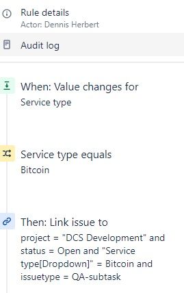

I am trying to understand the context for that error message.  If this is from JQL in a rule, would you please post an image of the entire rule?  Thanks!
Dennis_H
March 29, 2021
Thats the entire rule (with the true names). If I replace the JQL with the specific issue # it links.

Is this rule running in the "DCS Development" project?  If not, rules which impact multiple projects need to be defined an run at a global scope.
Dennis_H
March 29, 2021
I have it running just in the DCS Dev project.

Bill Sheboy
March 29, 2021
That is curious... Have you tried to branch on the JQL and then link them, one by one to the trigger issue?
Dennis_H
March 29, 2021
Hmm, not sure how that would work.
Bill Sheboy
March 29, 2021
Something like this, with only a small change to your rule:
  • Trigger: when value changes for Service Type
  • Condition: when Service Type equals Bitcoin
  • Branch: on the JQL you noted
    • Action: link issue to trigger Issue
This will link the trigger issue to each issue returned by the JQL in the branch.
