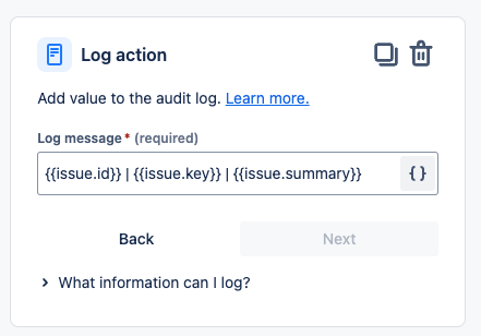

In an automation you can get the ID with {{issue.id}}:

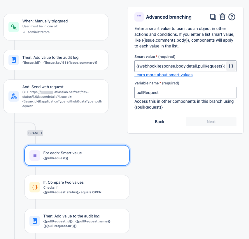

So then you can use the automation's "send web request" action, and smart branching, to emit the PR URLs.
Here's how I did it successfully:
Some things to consider:
1. That API is unsupported and may change randomly
2. The API seems to return multiple GitHub data sources in the "detail" array. In my case, 4 sources are returned and only 2 of them have links to the PRs. I don't know why there are 4 sources. For me the first data source always seems to have the PRs, but if another source came first in the array, it's possible this automation would break. I wonder if there are more query parameters that could be used to filter the data sources.
3. The "send web request" action will require authentication. I made an API key in my user profile under the Security tab. Then I mashed it together with my email like follows:
my@email.com:APIKEYHERE
Then I used a base64 encoder to turn that into one base64 encoded string. In the web request, I made an "Authorization" header with this value:
Basic BASE64STRINGHERE

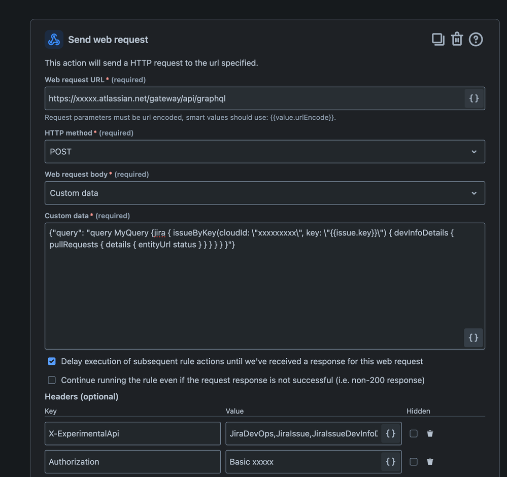

I actually successfully implemented a set of automations that trigger on Jira issue changes and on PR created that then use various web request actions to fetch PR info and "Request changes" on PRs as a bot account.
I wasn't aware of the API you are referring to. Instead I use the GraphQL API that the Development panel on the Jira issue uses to list the PRs related to the issue.
The system works ok for what it's supposed to do at the moment but it's hard to maintain since it involves several interconnected code-heavy (graphql queries in a web request action, request response string parsing etc) automations in a "no-code tool".
So I'm looking for a solution that would make this a) more maintainable and readable and b) more extensible (i.e. to add further conditions on when a PR can be merged), I have a related question here.
