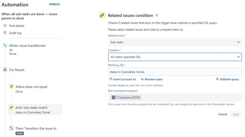

I have an existing automation rule that will set the Story to DONE when all the Sub-Tasks are set to Done (When all sub-tasks are done → move parent to done).  Works perfect.  We now have administrators using the Cancelled status in their Sub-Tasks, so I need to adjust the automation rule.
When: Issue is transitioned to Done
For Parent - Status does not equal Done.  And: Sub-tasks match "status = done". Related issues = Sub-tasks.  Condition = All match specified JQL.
Then: Transition the issue to Done.
When I change And: Sub-tasks match "status = done OR status = cancelled" or "status = done AND status = cancelled" the rule fails to transition if the sub-tasks are set to cancelled.  If one sub-task is set to cancelled and one sub-task is set to done the rule fires appropriately.  I have tried many possible variations in changing\adjusting the "And:Sub-tasks match" field.

Validate query was successful.  Automation rule did not work when testing against two sub-tasks that were change to cancelled.  Not 100% sure I set the changes correctly.
Related issues - Sub-tasks
Condition - All match specified JQL
Matching JQL - status in (Cancelled, Done)

Can you please share a screenshot of your rule and audit log?
Bill Ewald
December 5, 2022
Bill Ewald
December 5, 2022

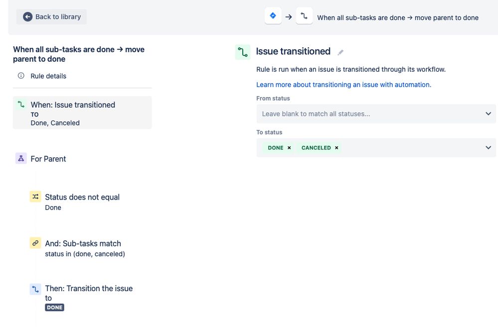

Ok - So your trigger is still only looking for when issues are transitioned to Done.  You'll need to include Cancelled in your trigger.

Mark I did see your last comment.  Trying to figure out where to add Cancelled.
Jack Brickey
December 5, 2022
please try this

Bill Ewald
December 5, 2022
That worked!  Thank you both!!
