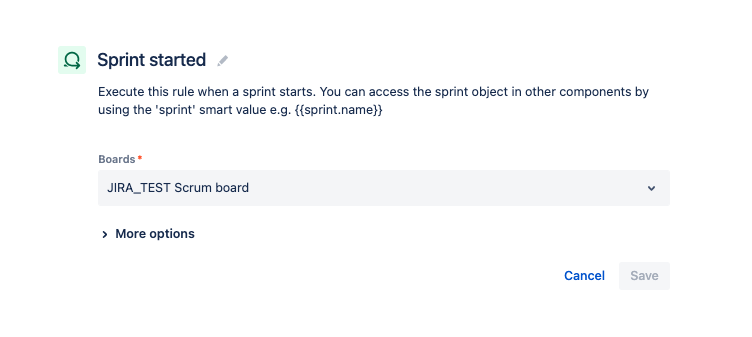

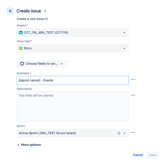

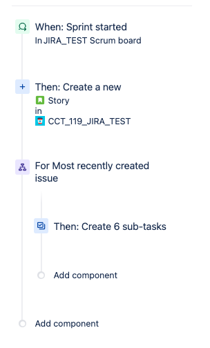

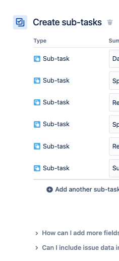

Here is my automation flow (read from the bottom to up):
Zrzut ekranu 2022-12-21 o 08.07.41.pngZrzut ekranu 2022-12-21 o 08.07.32.pngZrzut ekranu 2022-12-21 o 08.07.27.pngZrzut ekranu 2022-12-21 o 08.07.21.png

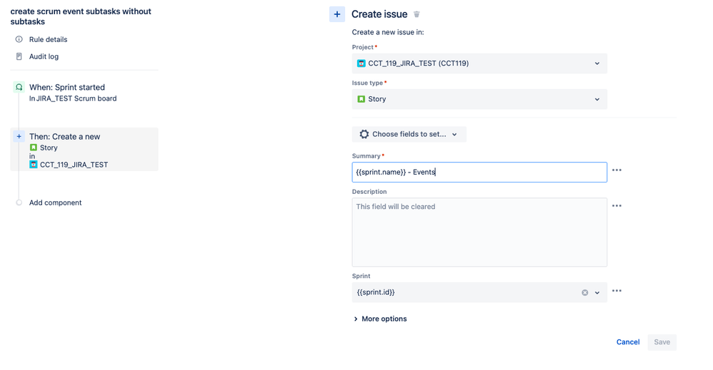

1. Could you try replacing "JIRA_TEST Scrum Board" in Sprint field on Issue creation with smart value {{sprint.id}} ?
2. Could you try if the rule would work with either of the way of setting the sprint just for issue creation without the subtasks? This way we might get the information if the problem lies in the subtasks creation or the main issue creation :)
Jakub Stephan
December 21, 2022
I have the same issue without subtasks defined. I guess that not a case.
Also with using {{sprint.id}} it's failing.

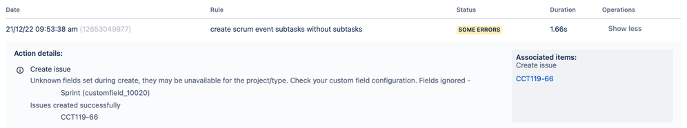

Audit log:
