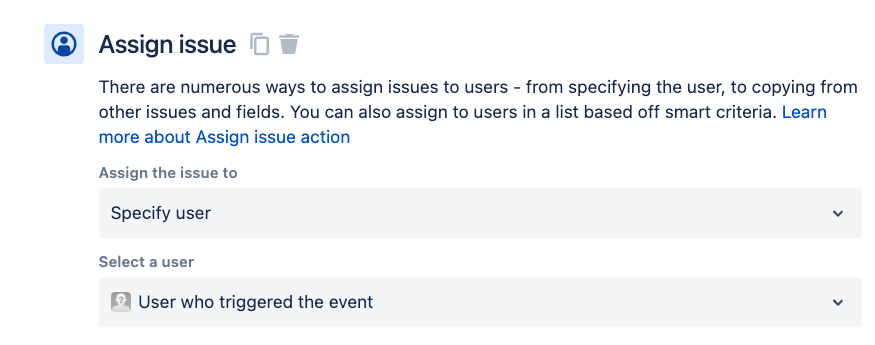

Option 1: Using the Assign User action [set it as User who triggered the event]

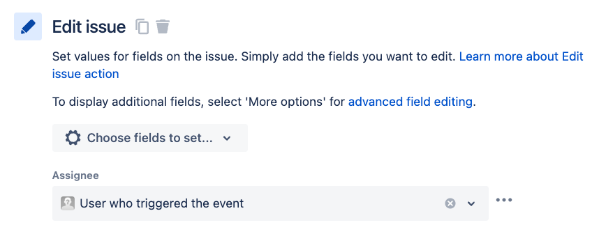

Option 2: Using the Edit Issue action [set it as User who triggered the event]

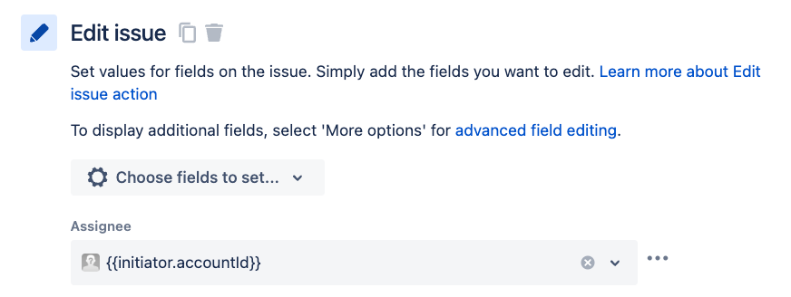

Option 3: Same as Option 2, but [set it as {{ initiator.accountID }}]

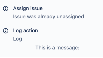

The audit log reports that the issue was edited successfully. Screenshot below is one where I had both the Assign issue and Edit issue actions enabled. Can see that the log shows it was ran without issue, but looking at the history within the ticket, no changes were made

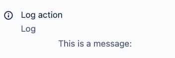

If you use the Log action to print the {{initiator.accountID}} smart value into the Audit Log during rule execution, what value do you get?
Using the log action, it doesnt return a value. In the action, my input is: This is a message: {{initiator.accountId}}. You can see the output doesn't return the expected account
