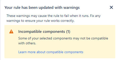

I thought this would be as simple as adding a "add comment" action, but when I try that, I get this error:

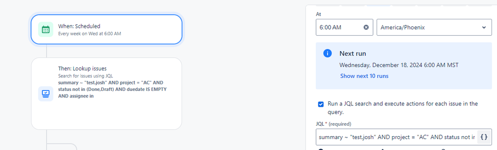

The only remedy I've found for this error, is to go back to the automation trigger (a Scheduled trigger), and enable "Run a JQL search and execute actions for each issue in the query":
Now, this works just fine - it does add the comment to the issues returned... but it breaks #1 above and instead of User A and User B each getting a single issue with their respective lists of issues assigned, they each now get one email for every issue. So each of these actions work perfectly on their own, but do not work properly when part of the same automation.

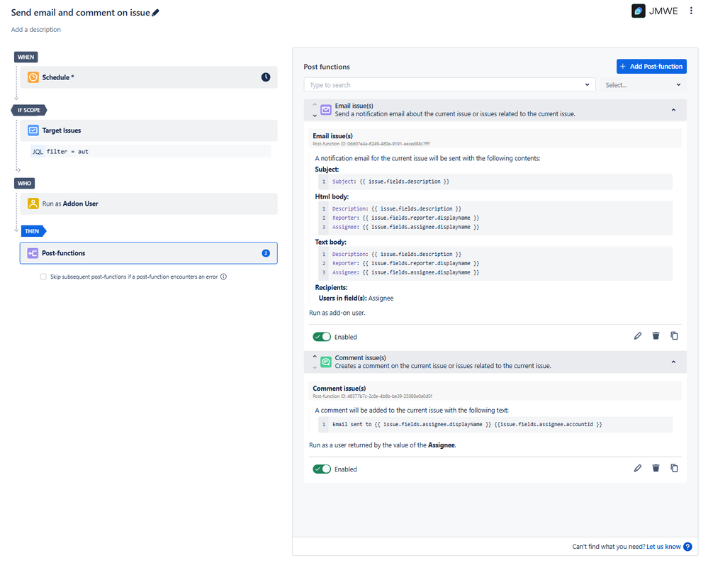

If you’re open to a plugin suggestion, I recommend trying our app, JIRA Misc Workflow Extensions for JIRA Cloud. You can create a scheduled action to achieve the result you are looking for in one automation:
  1. Specify when the automation should be executed.
  2. Use a JQL filter in the "If" scope by passing the filter in the JQL Expression.
  3. Choose to run the automation as an Add-on User, a specific user, or any of the options available in the dropdown.
  4. Add post functions; in this case, sending an email and commenting on issues where the email was sent.
Please refer to the attached screenshot for more details.
You can also find more information in our documentation. If you have further questions or need assistance, feel free to open a support ticket. We’d be happy to help!
