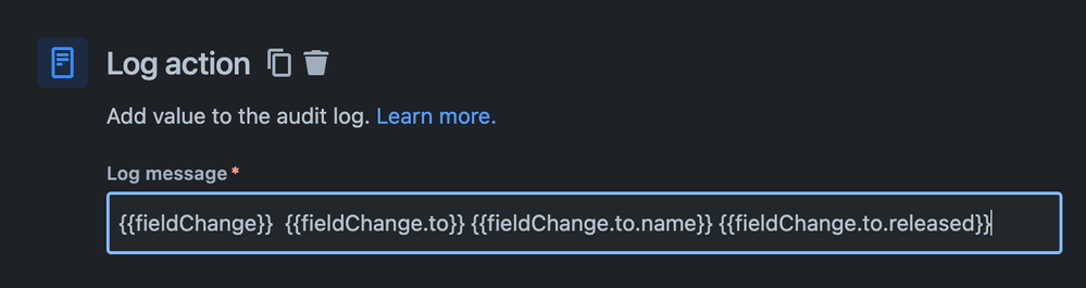

I'm trying to write a pretty simple automation rule: When somebody sets the "Fix Version" on an issue to a version that is already released, warn them that this should not be done.

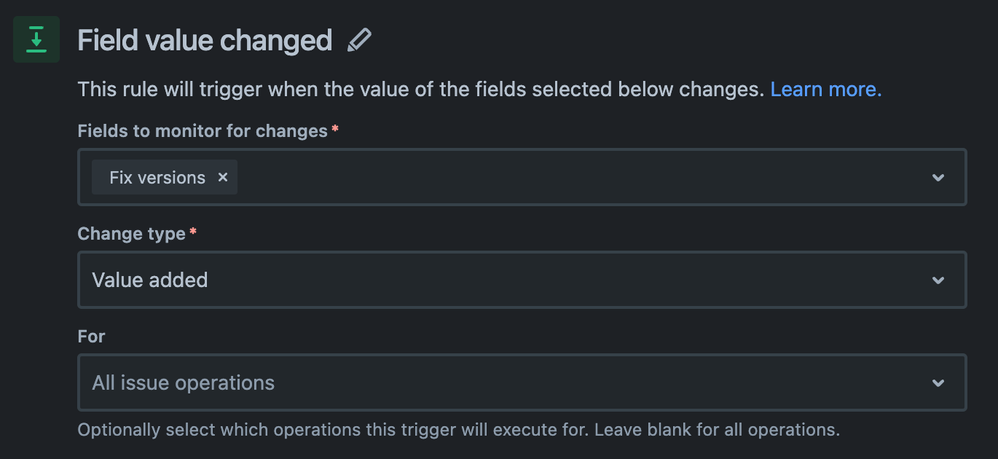

I have an automation set up to trigger whenever a value is added to the Fix Versions field.

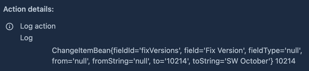

I'm struggling to check the {{released}} attribute of the smart value. I would have expected that {{fieldChange.to.released}} works. But it doesn't. I can get the ID and the name of the version, but not any of its attributes (see screenshots below). How can I write a condition based on whether the version that was just added is released or not?
Thanks for your help

I'd consider setting the "Change Type" of the Trigger to "Value Added".
That way, if a Fix Version is added (making for multiple versions), it could alert the user that the last Fix Version added was in a released state, or one of the last Versions added was.

There are known problems with automation rule parsing of the change log and list fields, particularly versions.  Here are a couple of them:
https://jira.atlassian.com/browse/JIRAAUTOSERVER-207
https://jira.atlassian.com/browse/JRACLOUD-81160
And so you may get a rule which appears to work, but its results may not be consistent.
Let's assume your rule can be accurately triggered and that {{fieldChange.to}} can accurately return a list of version id values.  In that case, you could use either:
  • The Lookup Issues action to gather issues with the id(s), grab the distinct versions, and then test the released attribute.  This is a variation of what Stephen suggested.
  • Call the REST API with a Send Web Request action to get all the versions, filter for yours, and then check the released attribute

Nick de Palézieux
November 20, 2023
That's valuable information, thank you!
I ended up implementing basically what @Ste Wright suggested, although I guess it's not going to be super reliable.

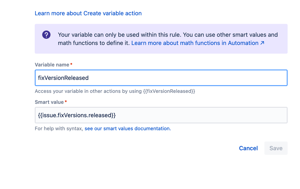

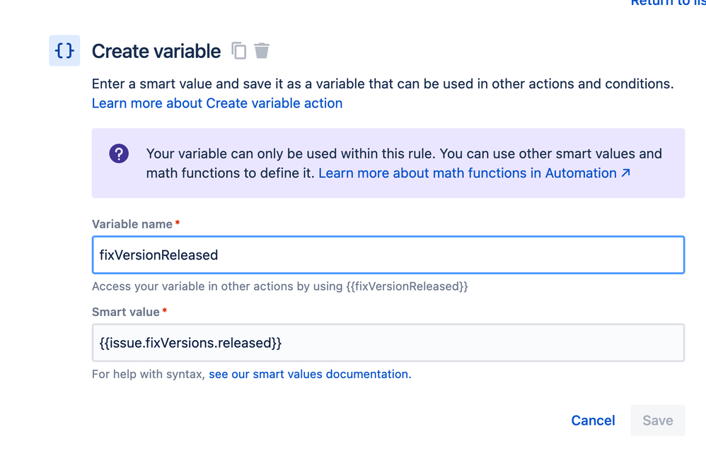

In this case, you can use the 'create variable' action. you can create a variable as shown in the screenshot I've provided and utilize it within the condition.

November 20, 2023
And what would you put in the "Smart value" input field for the "Create variable" action?
Murat Seven
November 20, 2023

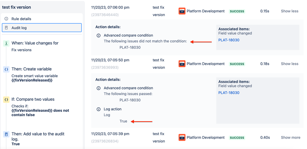

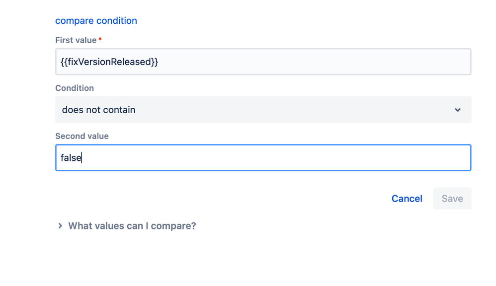

Yes, to provide an example using an issue: if fix version that had been previously released is added to the issue, you can detect this through the variable we've created. I'm sharing the details of the automation rule and the audit log screen below. With this condition, if a previously released value is added, the automation can perform actions accordingly.
