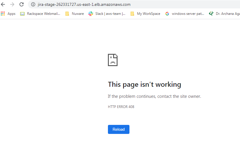

Hi,
This is the screen when i try to access the jira site.Am not sure whats blocking my site.Capture.PNG

Ok, a 408 is a timeout, which implies there is something there, but it's not responding to anything after the initial "yep, give me a sec to get some data for you" that a page sends back to your browser when first contacted (you'd get a 404 if there was no response to the first contact)
The thing that is running there will be the Tomcat (which will be asking the Jira it is running for the actual content to serve up).
So you'll need to look at why Tomcat or Jira are not serving up.
I would start with the application log, where you've looked already, but at the actual errors that are a result of it crashing.  If it really is stopping dead where you've cut it off in your post, then there is a fault happening in the application server, not the application, and you'll want to read the Tomcat log at <jira install>/logs/catalina.out to find out why it's hard-killing Jira.
