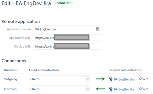

Hi Robert. Thanks for the documentation reference. I've tried that without success. When I use that method I get the "You do not have an authorized access token for the remote resource" response. I did note an interesting thing right below that where it fails in ThreeLeggedOAuthRequestFactoryImpl. I've seen references to two-legged authorization but not three.
Our Bitbucket is linked to Jira as shown here.
I've tried the various request factories (NonImpersonating, Impersonating, Authenticated) and all fail. I don't know if that's some issue with the way are authentication is being done.

Hi Brian,
Are you able to set your Outgoing and Incoming connections as "OAuth (impersonation)"?
This can be done, if you have the same users in both Bitbucket and Jira.
If you can set your connections to "OAuth (impersonation)", then I would follow exactly the code examples in either "Making Requests as the current User" or "Making Requests as another User" sections of the documentation to see that it works OK?
If your connections must remain as "OAuth" (i.e. because the users are different in Bitbucket and Jira), then I would follow exactly the code example in "Two-legged OAuth without impersonation" section of the documentation to see that it works OK?

Thank you, Robert. Our environment has the connections as "OAuth" so I'll have to check with I.T. to find out if there is a reason they don't want to have it set to "OAuth (impersonation)". As a test, I set our test environment connections that way and I was able to get the Jira ScriptRunner script to access data correctly when called from the Bitbucket ScriptRunner script. I'll also test the two-legged OAuth without impersonation like you suggested in case I cannot get the connections changed.
