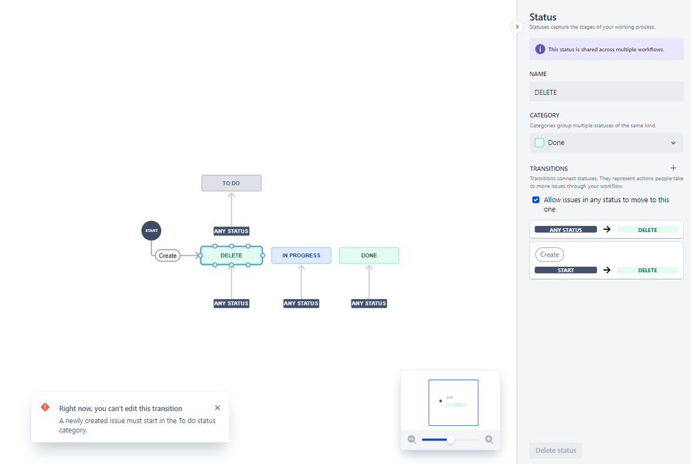

I am editing the default Jira workflow and I added a new "On Hold" status, which at some point was assigned to the "default" status (when a ticket is created). I now would like to delete "On Hold" (changed the name to DELETE), or at least reconfigure the workflow so that tickets go to "To Do". However I get a number of errors, none of which are accurate, but nonetheless prevent me from changing anything.

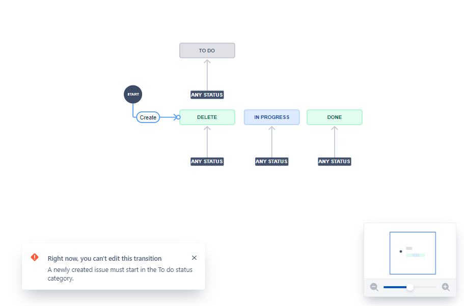

First, I cannot change the "Create" transition to set a new task to "To Do" I get the following error.

There are 3 status categories - To Do, In Progress, and Done. All issues created must be in one of those categories.
In your image, the Delete status is green which means it is in a Done type status category. So the message is correct, you cannot have a workflow with the first step being a Done status category type of status - it must be a To Do category.

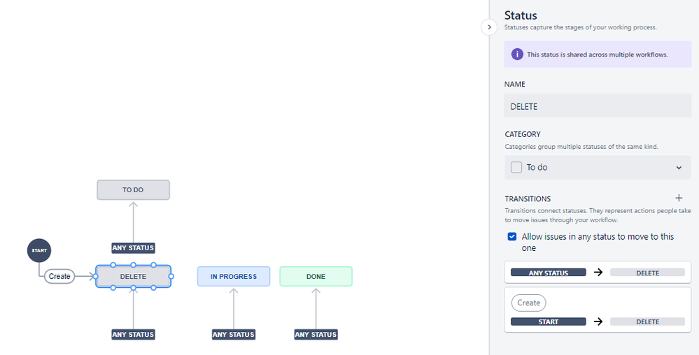

The screenshot I shared is actually showing a hoverover error that is not allowing me to change the DELETE status as the end-state of the transition, despite the fact that it is (as you pointed out) a Done status.

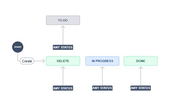

This is my current workflow.
However I am unable to drag/change the Create transition to end on "To Do", it is stuck on DELETE. This means I cannot delete the DELETE status. When I try to edit the Create transition I see the following:

When you click on the workflow like you have in the image above - can you change the category to To Do?
Michael Berger
March 29, 2021
Yes, I can change the status to To Do.
