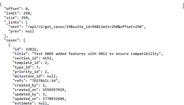

Step 1: TestRail data:
Use the TestRail API to get the list of Test Cases in a given TestRail project that reference Jira issues (have refs):
https://yoursite.testrail.net/index.php?/api/v2/get_cases/entertestrailprojectidhere&suite_id=entertestrailsuiteidhere&limit=250&offset=0
Max return is 250 - iterate using offset=0,250,500,... until no more results.

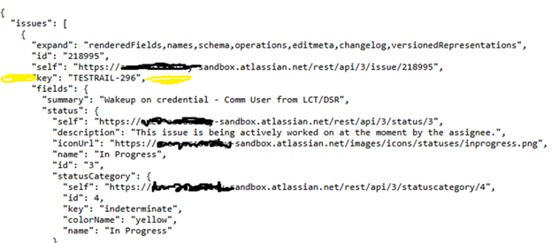

Step 2: Jira data:
https://yoursite.atlassian.net/rest/api/3/search/jql?jql=project%20%3D%20yourprojectkeyhere%20AND%20issuetype%20%3D%20Feature%20AND%20statusCategory%20%21%3D%20Done&fields=key,summary,status&maxResults=100
This uses JQL to set the search parameters. In this case, I limited it to Features with statusCategory != Done. You can add additional fields to retrieve the data but I only want to see Test Case coverage for Features so don't need additional fields.
Max return is 100, iterate using the "nextPageToken". If present, the nextPageToken will be at the bottom of your results page in the browser. To do this, add it after the list of fields...
...&fields=key,summary,status&nextPageToken=pastenextpagetokenhere&maxResults=100
You need to grab the token at the bottom of each set of results and continue until no more results.
