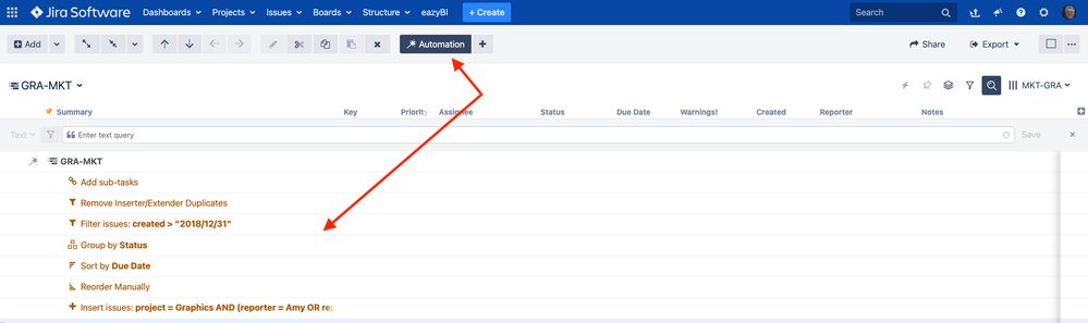

First, assuming this is a dynamic structure, Structure for Jira will display (or not display) your issue hierarchy based on the Automation rules that were used to build it.  Hint: you can view the automation rules, which may be hidden, with the Automation button shown here:

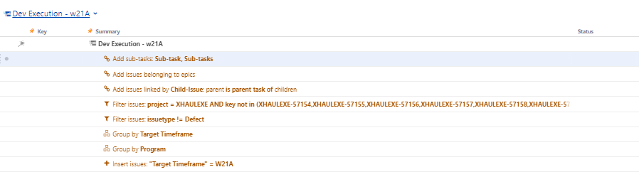

these are my rules for this specific structure (attached)

I'm posting an update here just in case if anybody else encounters a similar issue: the Initiatives were missing because of one of the Filter generators - it was removing everything that didn't match its JQL query, including the Initiatives. Changing the query fixed the matter.
