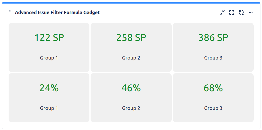

Danut M _StonikByte_
Atlassian Partner
December 19, 2023
Hi @Bernie Wu,
Not sure of this is possible in Jira Structure,  but you can calculate such numbers and  display them on your dashboard by using the Advanced Issue Filter Formula gadget offered by our Great Gadgets app.
Be aware that this app offers many other gadgets that you can find useful.
I hope this helps.
Danut.
